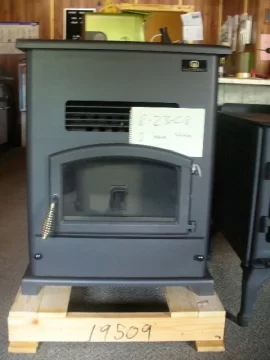

You have a few different styles of stoves picked out. Before you get your heart set on a stove, make sure you can get one. Please refer to just about every Harman post on this forum if you need to ask why I say that. I can help you out on the Big E. Give a call.
P.S. Like the visual aids?
Eric
330-876-0200
8-27-08 Sorry sold the last one and 5 coming the first week in Sept.

Maybe I'm a little slow. I read a bunch of threads, but I don't get the different styles of stoves, unless you are referring to the way they look, or the different features each has.
You wrote. "The stoves I am leaning towards are the Quadrafire Mt Vernon AE, or the Harman P68. However, I would like any feed back on the Breckwell Big E anyone could give."
P68 and the Mt Vernon look nothing like the Big E. This is what I meant about style.
Sorry for the confusion, just trying to help.
Eric
