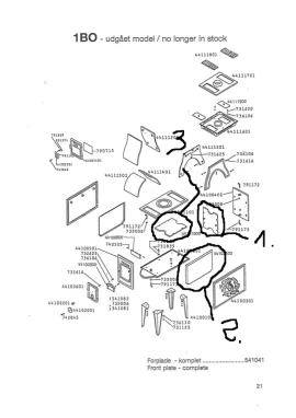

Hi there,
thanks for the reply. I attached the drawing.
I guess 1 and 2 are the metal plates and No. 3 is the baffle (firebrick)????
Unfortunately, to get the metalplates from america is a bit pricy. So i am wondering, if i can put instead fire bricks inside, like the pre owner did. We have two different kinds here. One is more for heatsaving, the other is more for insulation (vermiculite). Whats the better option?
I wanted to cover the bottom (protection), the sides and the top, each plates 3 cm thick.
Do you think this works or do i need some space to the outer parts?
The morsoe customer service is really no help, the lady didnt even know that there has been a metal plate inside.
