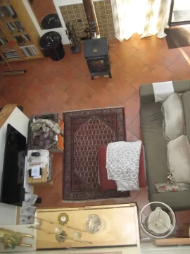

Since you're using small stoves, the best thing you have going for you is your new draft free well insulated house. :) It will drastically reduce your heating requirements. And since your floors are wood over concrete, had you considered cutting out a section of flooring and installing tile for your hearth? You can make if flush with the wood so there are no stubbed toes on the edges of the hearth pads. Tile is dirt cheap and your decorative choices are endless. Our whole floor is a hearth. ;)

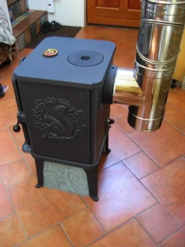

As to the stoves themselves, we have a Morso #1410 as our sole heating source. It's a simple practical rugged well built stove.

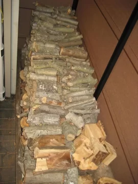

Even though the climate is mild here in Southern California, we built our 1,100 square foot house with 8 inch thick insulation in the walls and 12 inch thick insulation in the roof, so a small stove works great. I cut toy sized firewood for it. ;)
