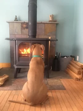

@begreen wanted to follow up a few months later -- I tracked down a Morso 3610! It was quite an adventure. The distributor company told me that it was the "last 3610 in North America". He must have meant a brand new one. The adventure is over and we have it burning in our home. It is a WONDERFUL stove. Thank you so much for your help back in August. Your advice helped me and my wife make our buying decision.
I have attached a photo of our dog Larry, enjoying the warmth.
Have a great new year!

Lucky you, congratulations! Looks like you may have to put a bed near the stove for someone.
It's a shame Morso has discontinued selling larger stoves in America. They make good heaters.
