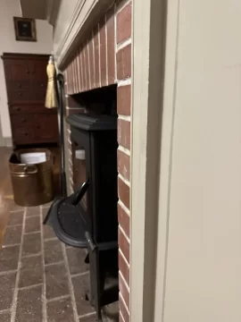

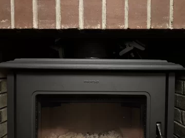

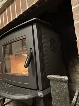

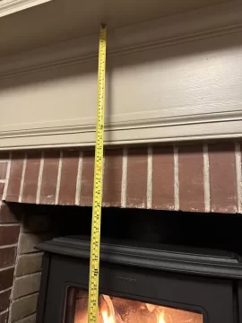

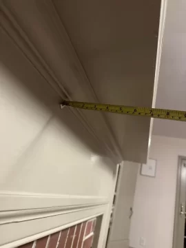

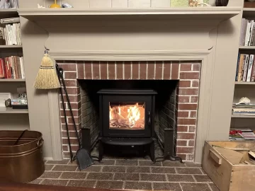

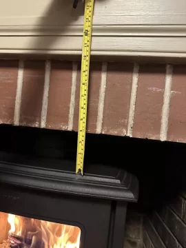

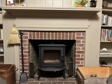

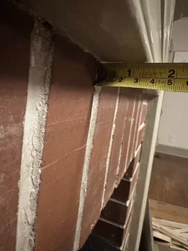

I just had a Morso 7110B installed in an open fireplace. It was unclear to me exactly what the clearance requirements would be in my situation since the stove is almost entirely inside the masonry firebox. The bottom of the mantel shelf and the thickness of the bottom surround are pretty hot and I'm running the stove gently just to test it out.
I'd love to hear peoples thoughts on whether I need a heat shield or other thoughts on this install in general.

Nice looking install! If it were me I’d probably install a metal heat shield right under that brick. Is there a metal lintle under there? You could screw some thin sheet metal to it sticking out as needed?
Is there a block off plate above the stove where the liner goes through?
Does the stove have a blower? If not a little trick to push more heat out of there would be to place a small muffin fan on the floor under the front of the stove blowing in will push the hot air up and out.

I was thinking of a heat shield right under the brick to deflect hot air out and around the mantle... There is a steel lintel. I could tap into that or maybe put some threaded inserts into the brick to attach a shield.
There is no block off plate. There is rock wool insulation stuffed in around the liner and old damper frame. If that doesn't work well enough (which I think it will) then I will add a block off plate.
There is no blower. Interesting trick with the fan. I've been thinking about a way to stick a fan at the top rear of the firebox to force air out.

Definitely install a heat shield. I second putting it right under the brick if you can. I put one underneath my mantle, which is 28" from the top of the stove, and it made a big difference. Maybe get some tapcon screws and put a piece of 2" angle on the face of the brick just at the opening of the fireplace?

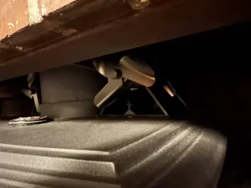

It has worked out pretty well. I have JUST enough room to sneak a small fan on top:
Amazon product
I actually have 4 of these things in there and you can't even see them because they're so far in shadow. It pushes enough heat out and away from the mantle that I feel OK without a heat shield.
The stove is small and, being installed almost entirely inside a firebox, it doesn't put out a ton of heat into the room. Don't expect it to heat your house but it does add a nice, noticeable, boost and I like the aesthetic.

Those fans don’t move much air. I have the 12” version of this and it’s great. It sits on the floor behind the stove and blow up. Air hits the block off plate on my stove and is directed across the top.
AC Infinity AIRBLAZE T10, Universal Fireplace Blower Fan Kit 10" with Temperature and Speed Controller, Compatible with Lennox, Hearth Glo, Majestic, Rotom Fireplaces, for Home Heat Circulation https://a.co/d/4XRyQKZ
I don’t have blockoff play in my insert and I stuffed rock wool up there. I’m getting enough stuff falling down that I want to get a real block off plate.

EbS-P - that does look like a better solution for moving air. I also do not have a block off plate, just rock wool stuffed into the damper frame around the pipe. That plus seeing the cord running across the floor are downsides but it would be nice to push even more air.

I don’t like the cord either but I have the thermometer wire too and two thermometer readouts. And to be honest it only get used about half the time. But when you push a radiant stove deep set like ours (because they are small this happens more often) a lot of the heat stays near the stove. I try to heat 1958 sq ft with 1.7 cu ft cast iron stove. It really needs the convective help.
