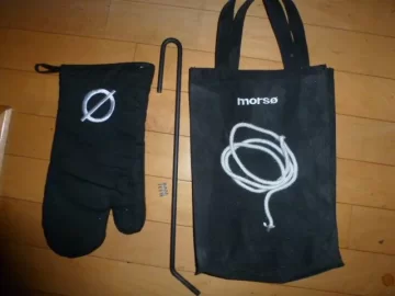

So, what is this white rope that is in the bag that came with the insert (5660)? I don't think it is a gasket, but don't know what it is! Don't see a reference in the manual. Thanks~
Got pic? Was it there to hold the stove info to the door if it were on display? Perhaps just an extra part, lots of stuff come with extra parts, sometimes they generate themselves, if you take something apart and put it back together, you may get extra parts.... who knows.
Switching from an Oslo to a Morso?
We aren't switching, we have both an Oslo, and the Morso. Here's what came with the Morso: [Hearth.com] Morso elastic white rope in kit
That, my friend is the secret "Danish ceramic flue connection gasket"
Tuck one end between the stove collar and stovepipe with a screwdriver, pull gently in line with the collar to make the rope thinner as you tuck it in between the collar and pipe. continue until you are around the pipe more than once.
It seals any leak very effectively and stays put. My installer said not to bother sealing as it was not necessary. However when I tried to fine control the air on my Squirrel 1410 the fire went out because of air leaks at the pipe, (Once the leak was bigger than the nearly closed inlet...No air) May not be a problem on larger stoves but a huge difference on mine.
Thanks, Squirrel! Now, the stove is installed already, and seems to be working all right. I wouldn't know if there was a problem or not, as a newbie. What happens or doesn't happen with an air leak? Seems like I am getting appropriate changes with the fire when I control the air vent.
I have a massive 3/4 cu ft firebox :eek: being sucked on by a very efficient 6" flue (They use 5" in Europe). As installed with leaking pipe joints my stove would either burn fast with the air at least 1/2 open or, at 1/4 open, the fire would go out because the primary air stopped flowing as the leaks and those *%$# secondary air holes let too much air into the flue. I sealed all the joints (which all showed creosote inside where the cold air was entering) and can now run the stove with just enough primary air to keep it healthy. With everything sealed (and the secondary air inlet half blocked ;em) I get a 2 hr+ burn and keep the glass clean as opposed to 45min burns before sealing it all up.
I kind of think that the bigger the stove the less of a problem this would cause but any leak will cool the flue.

I got the same stuff with my Morso 5660, only my gasket was much shorter. Yours looks like it could be long enough to be a baffle gasket. After a year or two of burning, you may find many of the baffle holes blocked with ash, and a vacuum cleaner won't clear them. You could just poke them with an awl or something, but you may want to remove the baffle and get the ash out. When I did this recently for the first time, I found a groove between the baffle and the rear wall of the stove, and 10% of a rope gasket. Not sure if that's normal (my installer was terrible). Anyhow, I bought some rope gasket and installed it when I put things back together. I used the small piece that came with my stove for the flue connection (I had to take the flue collar off for a different problem). The secondaries seem to fire sooner than they used to, but that could just be my imagination.
Meanwhile, I never did find any use for the spring or the oven mitt. Not sure what those are about.

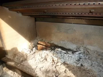

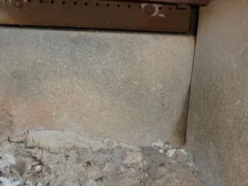

Here's our bricks:
[Hearth.com] Morso elastic white rope in kit [Hearth.com] Morso elastic white rope in kit
Sorry I've been away from this thread. Mass Burner asked about bricks, so I wanted to respond to that (belatedly though it may be). When I bought the stove, they said to be careful with the bricks, as I'd have to buy a full set just to get one replacement. The bricks that came with it (some kind of fancy vermiculite) were pretty beat up, as if they been used for years in a training demo or something, and the one that goes above the baffle was missing entirely. Anyway, it wasn't long before my back wall brick cracked. I was able to buy a new one, just that brick. The replacement was twice as thick, and I had to modify my bottom bricks with a rasp to make it fit. The next year, my bottom bricks developed thin cracks. This time, the shop wouldn't sell me just the bricks I needed. (rant deleted)
Anyhow, I decided to try burning this winter with the cracked bottom bricks, and see how it goes, and it's been fine. I'll probably install the new ones next fall. The newer, thick back wall brick is holding up great, as are the side and baffle bricks.
By the way, you must have seriously tough skin if that oven mitt works for you in the firebox! Either that or you got the non-flimsy version.
I'm not sure I would want a thicker brick, the box seems so small already. And definitely wouldn't want to have to modify things to make it fit.
I never use that mitt, am too lazy, that is why I always have burns on my hands.
