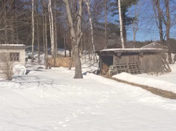

I have been planting the seeds for a new stove for some time. At 75 she is in great shape. She trucks out to the woodshed every 2 or 3 days to get wood. When there is too much snow she loads up a toboggan and pulls it to the house. It's kinda crazy. She just refuses to pay the oil man. That old defiant does heat the whole house very well. The pipe stick up about 10 feet from the roof. She likes the wood stove. The house is regularly in the high 70's to mid 80's when it's running. I typically am in shorts and a tee shirt when we visit. I was thinking non cat because she is use to running a simple stove. I like the idea of longer burns, don't get me wrong. I think a blaze king would work great. My fear is her knowledge of running it.
