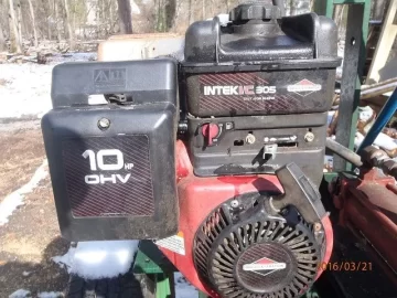

I did replace this 10hp

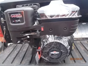

with the new improved
[Hearth.com] Motor for a splitter.
How do we refer to this now, Hp was easier!
Easy replacement. I do believe it's stronger than the 10hp.
I learned a lot with this project!
I also replaced the hydrolic filter, and topped off the tank with fluid.
