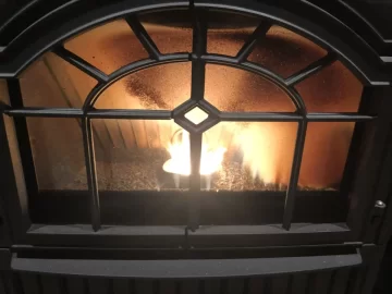

first off I want to say that I love this stove. It heats my entire house of 3200 square feet. I was wondering if anyone else has this unit and what have you found the optimum settings to be? Also my glass gets pretty dirty after a day of use. I don’t think that is normal. What would be causing that? I have attached a photo.

Dirty exhaust path, dirty firepot holes, too much fuel. kap
Yes. Eventually over a few days of burning, you should get a buildup of ash on the window. The bottom has an air wash that keeps it clean for a while. That is why it starts at the top. kap
