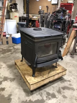

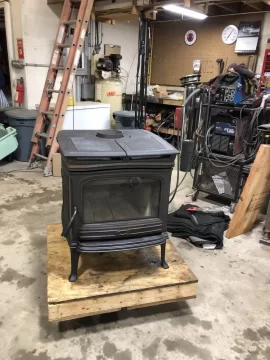

Well I got the stove home and there were no incidents, I made a pallet, we manhandled it onto the pallet that was on a dolly and shoved it onto the trailer.

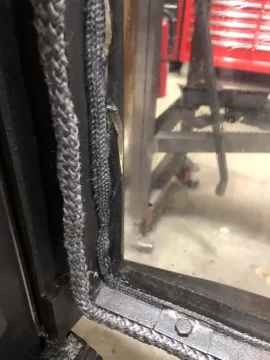

The stove is in pretty solid shape but I need to replace the door glass, the seller met me half way on the cost of that . I’m seeing aftermarket glass online for $151.00 . Im going to look into the cost of OEM glass does anyone have a good source for glass or opinions on the merits of OEM glass versus aftermarket glass? Take a look at the photo, I know it’s an air leak but is it unsafe to run like this ?

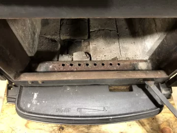

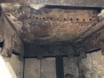

I’m also wondering about the insulation on top of the baffle and the support at the front of the baffle. one piece of the insulation was on top of the baffle going left to right at the rear and was essentially blocking the flue collar. There’s another piece that is shoved way down on the side of the baffle running front to back which seemed more correct to me. Can someone enlighten me on the correct position of the insulating pieces? The piece of angle steel that supports the front of the baffle is able to slide in the front to back direction ; is this ok and what position is correct? It seems to block secondary air holes when shoved all the way against the baffle but the angle support has holes so it may just need to be fine tuned to align the holes, again any input is great.
[Hearth.com] Moving an Alderlea T5 advice [Hearth.com] Moving an Alderlea T5 advice [Hearth.com] Moving an Alderlea T5 advice

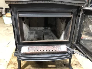

I think I’ve answered one of my own questions. I believe the guy I bought the stove from had somehow decided the boost manifold needed to be placed under the baffle as a support. There are three pins just inside the front door at the bottom of the fire box that are around a half inch hole; I believe the angle piece that was under the baffle is supposed to sit above the hole supported by the pins. I’m gonna add a couple pictures of what I‘m talking about. One picture of the piece in question, one picture of how the baffle area looks with it removed from what I believe was the incorrect location and the last with it in what I believe is the correct location. Can any one more experienced with this stove confirm this is correct?
The holes in the piece of angle should point into the firebox, not up at the glass. They direct boost air at the base of the fire.

The side blankets are L-shaped and nestle alongside the baffle for its full length. Our insulation blanket has a stainless cover, but some later models just had it fit on top of the baffle. It's orientation should match the baffle's.

From what I can see, the door gasket doesn't look too bad. Has it come unglued in spots? If so that can be quickly fixed with some RTV in those areas. Then do the dollar bill test. The Alderlea doesn't use a knife edge seal like the Super and Summit do, so the gasket density is important. The dollar bill should show some resistance to pulling out, but not enough to tear the bill.
If you have a new baffle gasket then sure, remove it and get the insulation blanket set properly and make sure the flame shield is in place. It will be heavier than it looks. Lift it off the supply tube in the rear, slide forward, then tilt up on the left side and lower it down at an angle to the floor of the stove.
