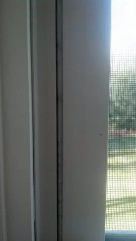

I am woefully ignorant about this. =( How are windows rated? Most of the windows in this house are Regal replacements, I believe they are standard issue, not their top of the line. I could be wrong about this but my impression is that the available upgrades are mostly about latches, etc. rather than insulation value. A few of our windows are sliders and casements and those are another brand... Skyline? I think? They do not appear to leak.
It was cold around the casement, so we added some weather stripping- it seems to help.
At any rate, we have swaddled up the windows. I don't think the windows are our primary problem right now. I think our problem is no wall insulation and perhaps a slightly undersized stove.

I was not being ridiculous- it's quite real. I looked it up online and I'm not the only person on Google complaining about this problem. The recommendation? Caulk. I believe Madcodger and I discussed caulking around the floor perimeter on another thread- or was it this one? Anyway, IT BEGINS TODAY, MADCODGER- THE EXPERIMENT IN CAULKING BASEBOARDS.
