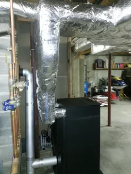

    20131202_205944_resized.jpg I like to use the fans i have built in place. Now i need to work on installing a thermostat on the pellet stove and some extra relays to turn the air handlers off and on as needed.

    That works bigtime on drafts if you cant afford to re insulate!
