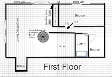

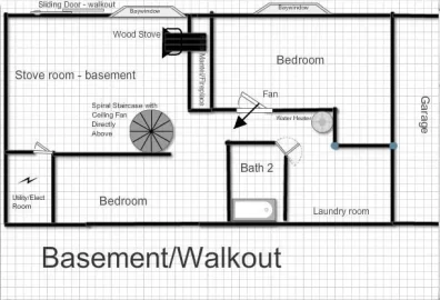

I have about 1800-1900 sq feet to heat. First floor is fairly open plan, bottom floor walkout is a little more boxed in. My stove is in the basement however there is a spiral stair case next to the stove with ceiling fan directly above it. I also have two floor registers over the stove between the walkout and first floor.
With the ceiling fan blowing cold air down to the basement there is a huge column of warm air shooting up through the registers. It is about 87 in the stove room. Without power and no fans heat doesn't go upstairs (can get it up to 66-67 upstairs while it remains 87 in stove room). Turn the ceiling fan on and the upstairs will heat to 74-75. The bedrooms do need a fan blowing towards the main room/spiral staircase to warm up appropriately.
The bedroom in the walkout next to the stove will be 68 degrees while the stove room adjacent is 87. Turn on the fan and the bedroom quickly warms up to 76-77. Upstairs bedrooms don't get as warm and are downright cold without the fans blowing towards the main room. But with the fans can get to 69-70ish. Not bad.
The upstairs bedrooms are guest rooms and if we have guests over we turn on the electric baseboard heat at night to make sure they stay comfortable as they typically keep the doors closed to sleep.
Without the fans and air circulation however the house other than the stove room does not stay very comfortable.

From a heating the air stand point that per minute figure is what you pump out a lot of which you have heated and then there is the same amount that you attempt to heat because what goes out must come in via other leaks. Most pellet devices can barely move that amount of air per minute. Some can but a lot of units can only come close running wide open. It is not just recessed lights that are a problem normal ceiling fixtures can have the same issues if not properly handled.
