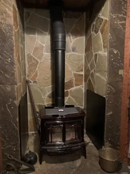

  • [Hearth.com] Moving on from a Lopi Leyden
I have been using the stove, just keeping the back damper completely open. And keeping the air supply choked down or completely closed.
Obviously have been burning through a lot more firewood, but no issues with overheating and definitely no draft issues or smoke issues like I’ve had in the past with the stove.
With the bypass open, it is not functioning as an EPA stove. Closing the bypass routes the hot gases through the rear, secondary, afterburner chamber for much more complete combustion and a lot more heat from the fuel.
With a tall 8" liner it could be draft is too strong. This can be measured with a manometer or Magnehelic. If this is the case then adding a key damper in the stovepipe could tame the beast.

The Leyden's design is very similar to the Vermont Castings Acclaim design. If the flue system's draft is within spec it can heat well, and like VC designs, it's a very attractive stove. But also like the VC it can be notoriously fussy when conditions are not perfect. Give it partially seasoned wood, or draft out of spec, and it can get grumpy and hard to manage. The Achilles heel is the refractory combustion system. It doesn't stand up too well to heavy 24/7 use. At 10 cords, it may be due for a rebuild.
I will look into evaluating the refractory combustion system. I do use the stove as supplementary heat to gas furnaces so hopefully, I am not going to be on the hook for an expensive repair soon. I’ll do some reading on how to inspect it and test it. Wondering if the refractory combustion system does fail, how will i know and what worse damage can that cause.
Thanks
Paul
When the refractory system starts failing the stove behavior will become erratic and either hard to control or it may become prone to balky behavior with frequent puffbacks. Given the supplemental use it may be worth a rebuild, but the parts are pricey. It's a shame because the castings and look of the stove are very nice.
