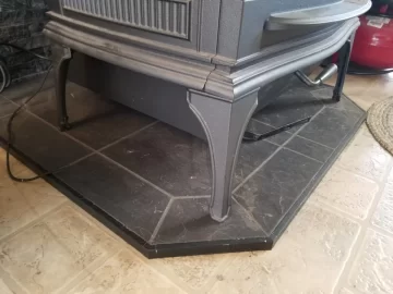

Here's a picture of the legs

If you can secure a couple of 2x4's to those legs.. get a couple of 1 1/4" pvc pipe pieces to roll it around on, should be pretty easy with 2 poeple. I have moved 600lb generators rolling around on PVC pipe.
