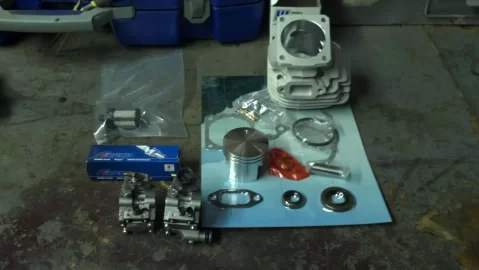

    Well, I ordered a Walboro 194 carb and a new Piston, cylinder, and ring kit, complete with gaskets. (44.7 / should bolt right up)
    Also need a new Air filter, spark plug, and fuel filter. But I will grab those fron my local dealer.
    With the BB kit and the Muffler mod, I will need the new carb. For $60, it was money well spent (in my opinion).
    All told, I will have about $265 in the saw, but it will be as good as new (hopefully :)) For the going rate of the average 026/MS 260, its still a good deal and it will have all new parts.
    Pics will be forthcoming, when parts arrive

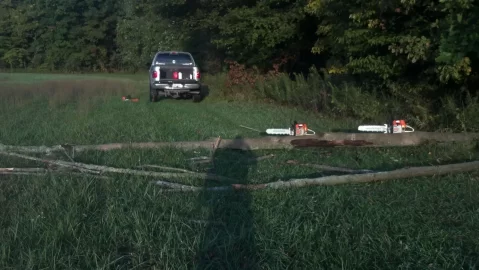

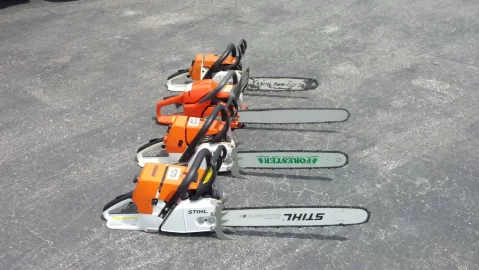

    Dexter,
    I am surprised no one has mentioned this, but your bars are upside down on at least two saws shown in the pic. ;lol
  15. DexterDay
    DexterDay
    Guest 2.
    I like to cut "Bottom up"! ;)

    CT-Mike, he can't spell;) he also likes bottoms up [​IMG]
    DexterDay likes this.
  17. DexterDay
    DexterDay
    Guest 2.
    Eye Kan two spel.... Me n mi cusin gradiated twogeter.
    Cee my piks.
    (All in good fun :))

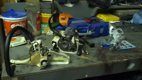

    Ok.. For those in the know, I thought I looked at the Carb/Throttle linkage pretty good before taking it off (should have taken a pic :(). Now I cant seem to get it on the carb. I took the top of the handle off to remove it.
    Now I cant tell if it goes over or under the choke/start linkage?
    I got all my parts in this week. The Piston, rings, cylinder, fuel filter, seals, spark plug, gaskets, and Walboro 194 carb..... This Carb has me Stumped (linkage).
    Also, the arrow on the piston, points towards the exhaust port? Correct? OEM has an E on the exhaust side. Aftermarket has an arrow.
    Thanks for any help on the linkage and piston direction.

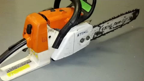

    No problem. Its done. A buddy came over and helped. Runs like a scalded monkey!!!
    All told. Less than $300. And now its basically a Pro without a De-comp button. (If I remember correctly, Pro's were the Walboro carb, 44.7 mm bore, de-comp, and adjustable oiler? No?)
    It now has the 44.7 mm bore, new seals,Walboro 194 carb, new fuel and air filters, new bar and chain, and had the adjustable oiler.
    Going cuttin in the a.m....
