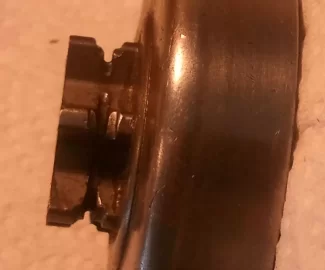

The sprocket will "function" long past it's usable life. It will just cause issues. #1, a worn sprocket will increase chain wear, #2 A worn sprocket can make it rather difficult to get chain tension properly adjusted. Neither of those sound like a big deal but for the cost of a new sprocket I'll buy a new sprocket all day long rather than fuss with eating up chains and having to constantly readjust chain tension.
Here's a guide: when sprocket looks like this - replace it.

so basically these spur sprockets dont' have any grooves in them when they'ren ew. so when you get deep groovesi t's time to replace?
No grooves when new. Minimal swear shows side grooves. Moderate wear and top ridge starts dropping down - approaching replacement time. Look at the outer 1/3 of sprocket - what it all will look like new.
