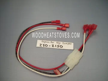

Sounds like it may be your auger motor's capacitor, which when it starts to fail will run the auger motor in reverse for a cycle, then forward for a cycle, but not always consistently. A common problem with these feed motors apparently.
Here's a link to the replacement capacitor loom you can wire in, from Wood Heat Stoves for $18 + shipping, vs $180 or more for the whole new auger motor (which includes the capacitor loom as well). (broken link removed to http://woodheatstoves.com/feed-motor-capacitor-p-2062.html)
This capacitor jumper is for all Quad stoves except the AE. It has a DC motor instead of an AC motor. You may just need the optical sensor instead of motor.kap
Ooops..... I didn't look at his stove signature to see that he has the AE.
It looks like the old MV non - AE stoves (pre - 2006), like one of the other guys who posted a question earlier, had the AC motor, then they went to the DC motor when the AE came out? Too many posts, and stove types, to keep track of ! :confused:
Yes, the AE is all DC, except the igniter. That way they could have the battery back up for it. And you got that right about too many stoves and changes and posts. lol
