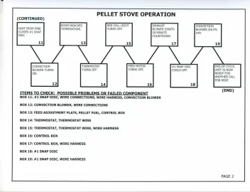

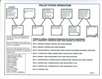

What you need to do is have your father in law there now. He can trace where power is, and where it isn't, when stove is calling for heat. Process of elimination.Is green light still flashing? You can also try jumping snap disc #2 wires together and vac switch wires together, to eliminate them. Just always make sure nothing can get grounded as it will short out your control box! Hopefully tjnamtiw can post the pic of start up sequence on here for your father in law to follow. kap

Here it is - I figured it out on my own ! [Hearth.com] Mt Vernon Quadrafire won't ignite [Hearth.com] Mt Vernon Quadrafire won't ignite

DMKNLD, no my #2 snap disc doesn't have the red post like the #3 snap disc, but it has a little plastic button that I believe once it pops, you can push it back in. I was not aware that there only a few times you could reset the snap disc then its no good. Maybe thats the problem here? Although I used a wire to bypass the #2 snap disc and that still doesn't solve the problem.I jumped the two wires together and still nothing. Those flow charts are very helpful. The vacuum switch wires are the two on the bottom left side below the control box that go into the vac switch right?
