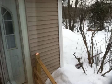

Jack: Effectively a leaky basement space. To store pottery, previous home owner built a greenhouse-like space (large glass windows) with a shingled roof. To get under the space from the green house would be tearing out a plywood ceiling covered in flourescent lights. More than I want.
Enclosed photo: snow covers the greenhouse roof and most of side windows. Door on left is mudroom exterior door. Photo taken through the kitchen window.
