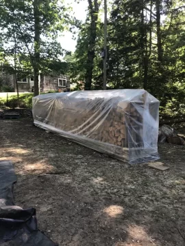

I Have to thank this forum and it’s members ingenuity I feel I’m still new at this as compared to most of you. I apologize for not taking moisture readings. I went as far as taking the meter to the back yard, also I’m missing a major component, solar! We’ll see!
[Hearth.com] My attempt at kiln[Hearth.com] My attempt at kiln
7 pallets on the ground with 3 or 4 pallets vertical in between for stability, built up the ends to add height. Stack is about 5’ high, 24’ long, two rows of mostly black locust. Peak is about 6’ high, covered in 6 mil plastic with vents cut in the gable ends. I wrapped the bottom with that stretchy plastic Saran Wrap stuff.
I should’ve stacked wood wider on pallets, the stretchy film doesn’t really do much so I ended up stapling the plastic to the pallets to keep it tighter. A sunny spot would probably help too!
You need some vents top and bottom. Not to much you need to build heat but you also need to let moisture escape.

Not at all as long as there are vents to allow moisture to escape. I did something similar last year and got my combo of red and white oak down to between 15 and 18 percent in about 5 months

You will get condensation on the inside of the plastic that is what happens as the water is driven out of the wood no way around it.
looking at your kiln there are no vents. with a kiln that long you will need vents on both ends as one in the center.. cut the vent in a u shape so you can adjust it if Necessary. you also need to open it up at the bottom to allow air to come up and in and go out the vents.. you look pretty shaded so I'm not sure how you going to get alot of solar gain. it would be best to take a temp reading and post back what the temperature is on the inside. iv had mine up to 140 degrees during the peak of the day like 3..4pm

Mine was almost to 150 one time I checked. But it is on asphalt with full sun. I agree that one doesn't have enough vents

mine sits in the yard so no asphalt but the key is the sun to operate it correctly.. im hoping he gets alot more sun than in the pic..

I would feel better about it if there were cinderblocks or something under the pallets. The thing to watch is the condensation that collects on the inside of the plastic. If it can flow down to the ground and out on the inside of the plastic surface it will probably work good.
If you end up cycling the same water in and out of your wood over and over, maybe not so much. Keep a close eye on it. Thanks for pushing the envelope on design. If the condensate is getting out and away it will probably work fine.

There are vents.

It worked! 16-18% with my cheapo MM. Unprouncable hurricane “Isaias” beat it a little and I really wasn’t concerned at that point. I was impressed it held up so well, this is really poorly constructed! I did enlarge the vent at both ends, the storm really enlarged it at one point. I folded and stapled to at least minimize rain getting in, that was August 5th. So two months in not a great spot but was in direct sun for a few hours a day ,then badly patched for 5 more months.
I opened it and took a few wheelbarrows in to the unfinished basement with my dwindling supply of know dry wood. My basement is cold, it’s 47 down there now, so I stacked the kiln stuff in the rack next to fireplace for two days. This is my first time with black locust, burns well, sometimes the coals will crackle and small sparks fly out, really fun. Dog loves it!

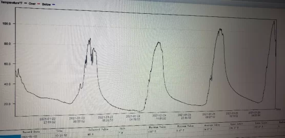

A temperature graph of my solar kiln. I have seen it at 180 in summer.
