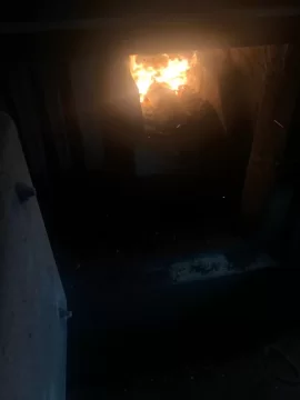

In regards to the Superior wood pellets I adjusted to the medium air adjust a bit higher and now everything burns to a fine powder. On the Maxim when you adjust the air higher the feed rate is also increased. So I'l see how that effects consumption with it burning a bit hotter.

Based on what your saying in your post you need to adjust the feed rate (item #1 above) to accommodate the volume of air coming into the burn chamber. Sounds like you have plenty of air and not enough fuel.
I would also suspect you should be seeing a bunch of water/ice from condensation at the bottom of your chimney stack due to insufficient heat. That will go away once you adjust the unit.
