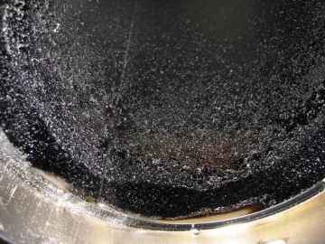

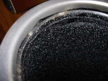

Check out the picks of the creosote in my stove pipe and chimney pipe, after about 2 weeks of newbie burning in my new Oakwood.
I have always suspected the moisture content of the wood I'm burning, but the stove WILL run away with the wood if I get a good bed of coals, and peg the stovetop thermo at or above 600 if I let it. At this time of year, a 500 deg burn for any length of time cooks us out of the room it's in (although the cats like it), so I try to maintain it at around 400.
But overnight, when I try to slow it down for an overnight burn, it will drop down to 350 and hover there. Is this too low for a burn without creosote buildup? At these overnight temps, my front door glass blacks over really fast, although I don't take precautions to keep the wood away from the glass.
Does the visible creosote warrant cleaning this soon, or could I minimize/reduce it by doing hoter, longer burns?
ALSO, I just noticed streaky creosote drips running down the top 5' of the EXTERIOR of my nice, shiny stainless chimney. Is this at all normal, and will it go away, or do I have to go up there and risk my neck and clean it off?
BTW, I've begun paying attention to the smoke coming out of my chimney, and at a 400 deg burn, I can regularly get a zero or low-smoke condition.

Yer getting this after 2 weeks of burning???? It ain't right. Gooey drips running down your stainless pipe ain't right. Quickly blackening of your glass ain't right.
If you are questioning your wood MC then test it to be sure. My guess is: you are probably right in questioning it.
If you are questioning if your temps are too low, my guess is: your probably right.
It does seem to be an abnormal buildup in such a short time frame. Think about what this pipe is gonna look like in 2 months.
If you have seasoned wood and are burning correctly, this shouldn't happen.
Edit: 350F (I assume stove top) is probably not going to be a hot enough burn for your stove, especially if this is before the coaling stages of your fire. You are probably not maintaining a safe stack temp, which in turn makes your pipe a creosote factory. Your black glass also leads me to believe that you are running too low of a temp or have poor wood quality, or both.

Also I agree it's hard to make out how much cresote we are talking about here.
I burned for 2 @ weeks in 30-40 deg. temps.
The horizontal pipe had some light brown "cornflakes" and the chimney just had some light brown "dust" on it.
The soot you're looking at in the photos is about 1/32" or less, and the first pic was at the top of my inside-the-house 48" single-wall stove pipe. The second pic was of the bottom of my double-wall chimney pipe going thru the ceiling, and looking up the stack with a flashlight, the flakiness you see kind of stopped maybe a foot higher, with random patches going up to the top, but mostly smooth, dusty pipe.
But that was BEFORE the creosote dripping was observed way at the top under the top cap.

Me thinks you have air infiltrating the pipe at that junction!
Possibly wood on the too moist side.
A 300 degree temp a couple feet up the pipe should be more than hot enough to keep creosote at bay. Try to measure the temp on the pipe. IF a magnetic thermometer won't work, they make ones with a spring type band that wraps around the pipe.
Ya know, after looking at those pics some more it seems to me the pipe could be installed incorrectly. It does not make sense to me, that there is a lip on the inside of the pipe that it appears the double wall sits on. Look at how the creosote is peeling away at the lip. To me, the lip is obstructing your draft. Probably swirling smoke around,creating creosote, instead of it being expelled quickly out the top. Draft is also important to prevent creosote. Boils down to the temp and velocity of the draft up the pipe. Sure seems like the problem is localized to this spot. Almost like installed upside down. Male couplings should face up, female down if I remember correctly(well this seems to be system manufacturer dependent). Inside of pipe should be smooth and unobstructed all the way up. No lips, bumps, ridges.

I would see about the same amount of creosote in my open fireplace(clay tile flue) after 1.5 cord of burnt wood.
I wouldn't burn anymore until resolved.

I think at two weeks, even with fully seasoned wood you will be getting some creosote buildup because you are learning the stove. The warm days only help the situation. Personally I wouldn't sweat it yet.
Most of the creosote that forms in my system forms in the singlewall before the smoke hits the chimney itself. If you are nervous about it, when you have the pipe down to inspect it, run a brush through it and up the foot or two of singlewall.
Do you have a cap on your chimney? If so, the outside drips may be from smoke condensing on the top of your cap and dripping off it.
