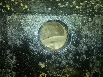

Last night, I was starting a burn, and and smoke was just everywhere. I didn't think much of it at the time, just thought maybe I wasn't paying attention or something. Well, just happened again, and after looking a little closer, the damper was still shut, even though the door was open with the lever pulled out. So I poked at it with a rod and it just fell right off.
2 Questions.
1) I probably shouldn't run the thing like this right?
2) Any suggestions on how I should go about fixing?
I have started taking things apart yet.
  • [Hearth.com] My Damper just broke?  EKO 25, what next?
Looks like the nuts just fell off of the threaded stud on it. It should have 2 nuts tightened against each other on that stud to allow some movement on the flap.
You can access it by taking off the panel on top,should be an easy fix,don't use it until you get it fixed though.

I hope it did not fall down one of the tubes?
It would just end up down in the lower chamber in the ashes.Might have to sift thru the ashes to find them.
I pulled a good one a while back. Was looking down the tubes after cleaning and dropped a flashlight down one of the tubes. It was a long flashlight so it wouldn't make the turn and come out the bottom. Finally hooked it from the top with a piece of wire and pulled it out the top.Duh!
I found the bolt, but not the nut yet. Are there any YouTube Video's or something that may show how to clean an EKO Boiler and what I should be doing?
