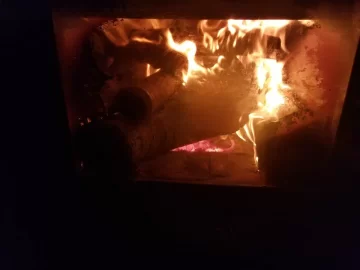

Just started my second season. Better this year than last! I think having the right wood ready ( minimum 6 months seasoned ) made the biggest difference. I've only been half loading and it lasts a good 4-5 hours before needing to reload. Temps are fairly mild here ( 30-50 degrees ) right now and keeping the house over 80 seems too wasteful lol. So far I love this thing. Been cooking in it non stop since I've fired it up. I even got a stovetop percolator for her and have made coffee and tea.
Awesome non cat stove!

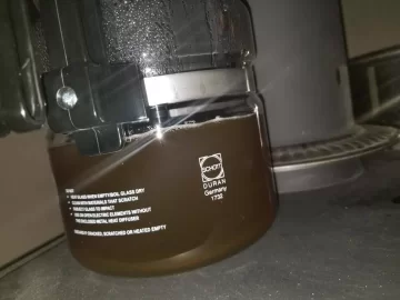

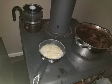

Just today : here's baked potatoes, roasted eggplant ( not sealed on the ends ), and roasted baby Bella mushrooms in olive oil and Himalayan pink sea salt :) I also did Thai satay chicken roasted but didn't snap a pic. Originally the wife was going to use the glass top stove but I figured why not use the wood stove for that too lol. Because the heat isn't exact, it's important to keep an eye on things. The chicken ( breasts cut as strips and marinated ) only took 15 minutes baking and was perfect!
Plus the top was used the other day for ramen and now I've been percolating coffee and green tea :)
Why use the electric stove / oven if I don't have to right? Also, it saves money on the bill lol!
Plus I'm cooking on sugar maple.... It added a nice smoked flavor to the eggplant and mushrooms, and satay :)

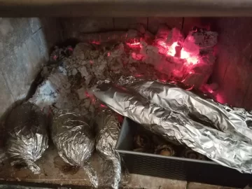

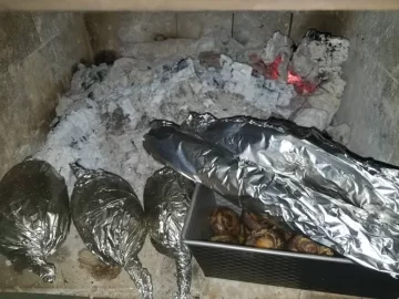

I've done steaks and pizza in the stove before, I bought a cheap pizza stone from Home depot and used that, it did work great but was a pain to remove even with welding gloves

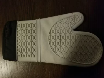

Don't cook when you have massive amounts of fire or wood in it for one. I use a simple silicon glove and tongs. I set cooked things onto a bamboo cutting board. No issues at all lol
I figure a half load at 7am gets me to about 11am. By then I have nice coals to cook on. Then repeat if I want to cook dinner in it. I only give it a good bit of wood overnight or if I'm leaving the house. ( Still roughly 3/4 full ). Still have plenty of coals for an easy light. Just toss a couple splits and some bigger stuff on top and she is good to go.
