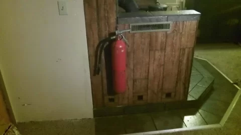

Two comments though. I had to use four layers of durock to achieve the r value required. Are you sure your hearth meets that?
A fire extinguisher is a great idea, but you may want to station it *away* from the stove. If you ever need it, you want to be able to reach it.
With steel studs, mineral wool in the air space and then the cement board the hearth is well above the required R value.

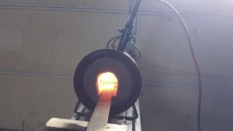

a 1" ventilated air space is good for like 1.43 of the 1.5 required. each layer of durrock is good for .39. the mineral wool is good for about 3. so my pad has like a 5r value. and that's ceramic wool which is wayyyyy more heat resistant than fiberglass. 2 inches of it in my gas forge keeps the outside cool enough I haven't even burnt a sticker that's on the side of it.

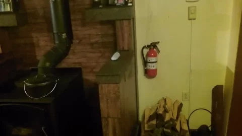

fire extinguisher wasn't mounted yet in that pic. I may change out the big 1 cause its old (but it still has a good charge) and the new smaller 1 looks a lot better.
