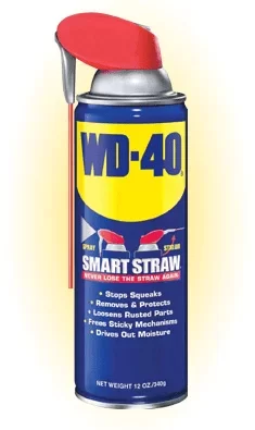

One more question: the owner's manual says to apply "penetrating oil" to the screws after cleaning behind plates. Do you do this? I've never heard of this oil...
one example of penetrating oil.

Ha Ha on the "penetrating oil". Who says that? Everybody calls it WD-40!
