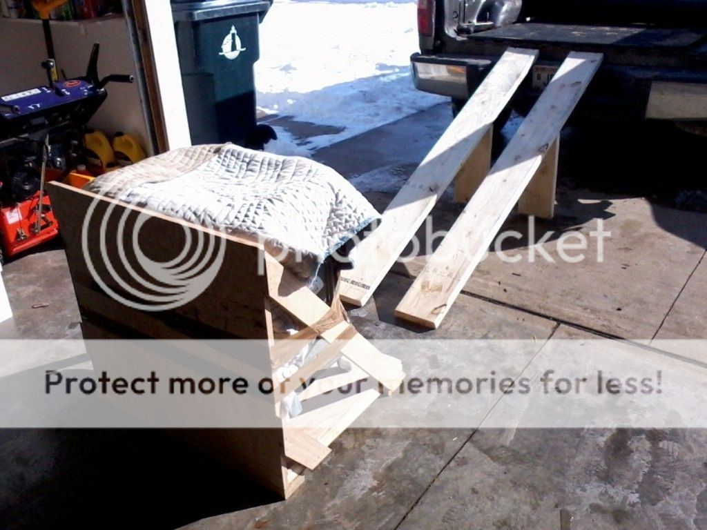

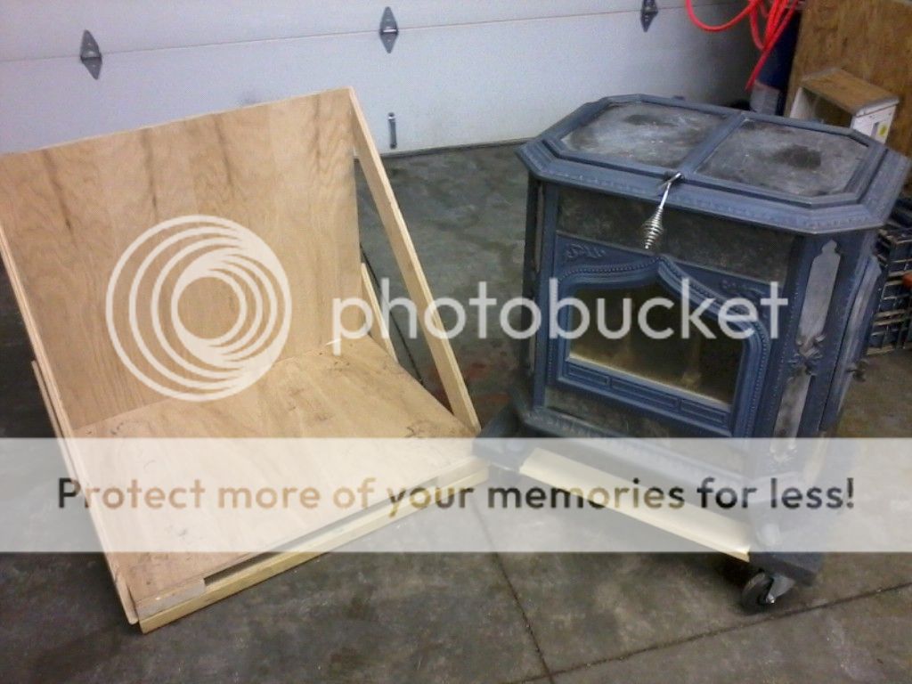

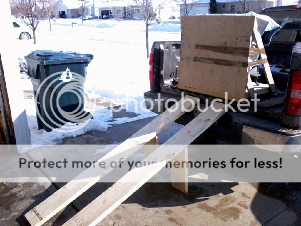

The first order of business after picking the stove up was to unload it from my pick-up. I tried to find an Escalera to rent to load and unload it but didn't have any luck so I built a "box" to put the stove in to help protect it during the loading, unloading and the drive (I traveled roughly 450 miles each way to pick up the stove). I don't know if I can actually call it a "box" since it is only a bottom and a back with a little bracing on the sides but.....
[Hearth.com] My Fireview project

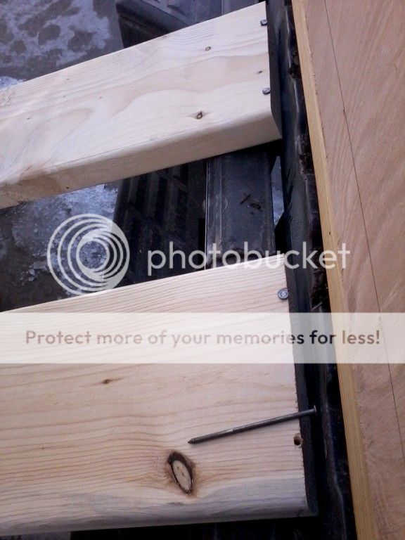

I used a couple of 2X8X8 for ramps. I cut about 16-18" off the length and use them to support the middle of the ramps. Where the ramps rested on the bumper, I drilled some holes and inserted some 16d nails in the gap between the bumper and bed to keep the ramps from sliding off.
Using this set up, I was able to unload the stove by myself.

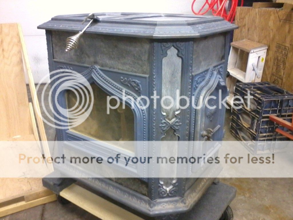

Once it was unloaded, I needed to get it up on a furniture dolly. I wasn't able to do this by myself so I enlisted a couple of neighbors to help. We got is slid off the box and onto the dolly with out any difficulty and the dolly was just the right size for the legs to sit on.

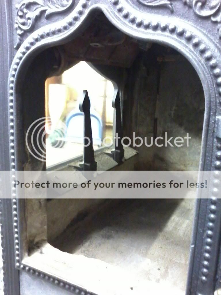

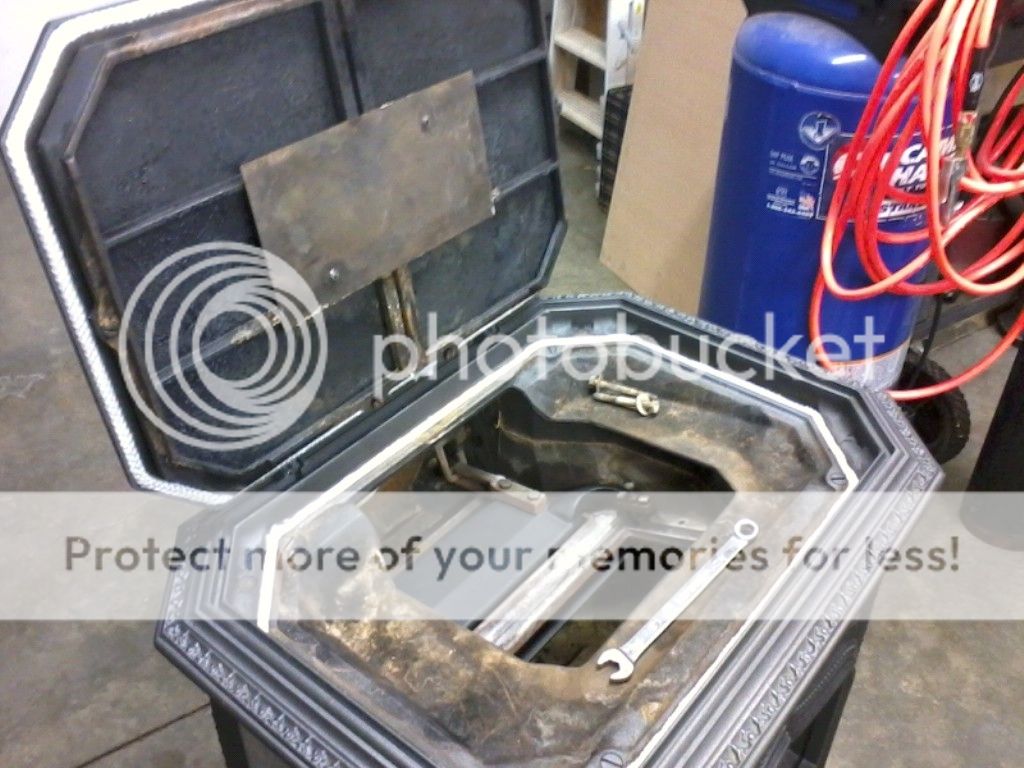

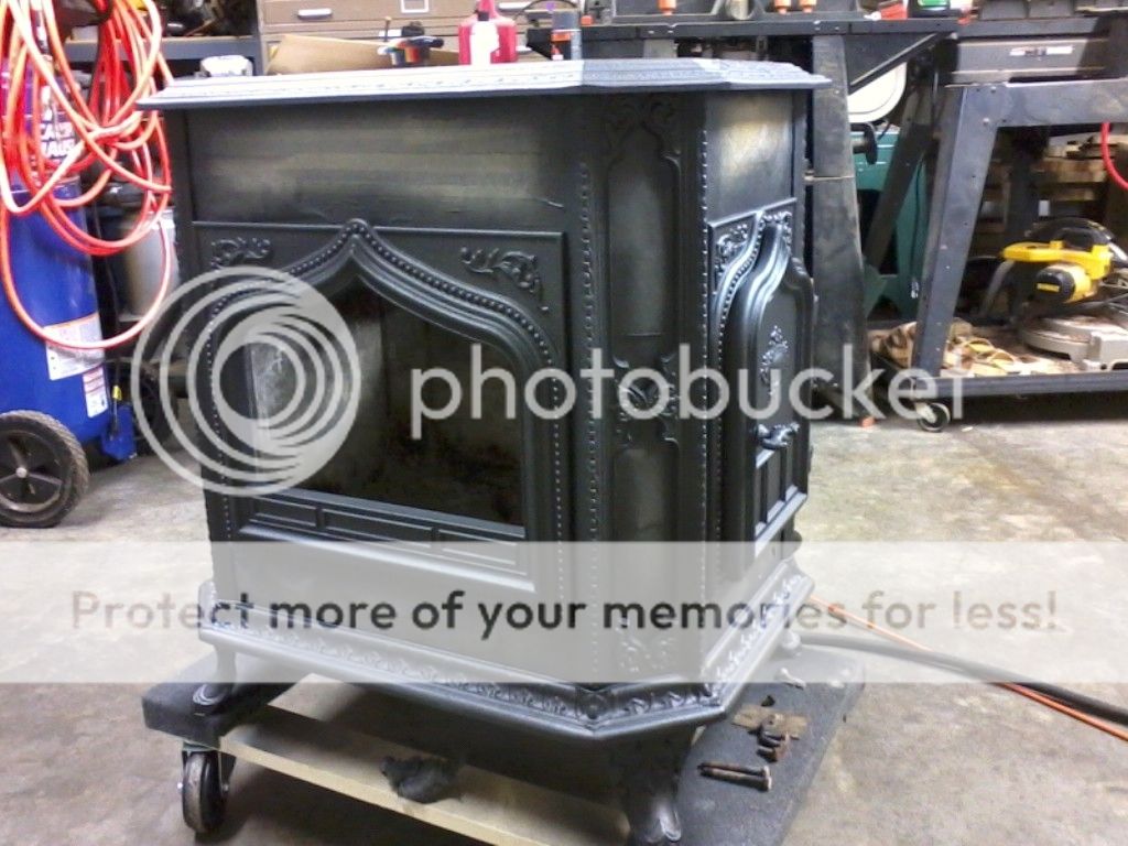

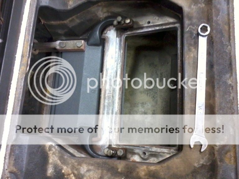

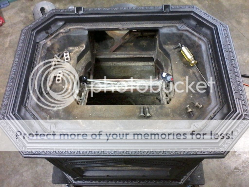

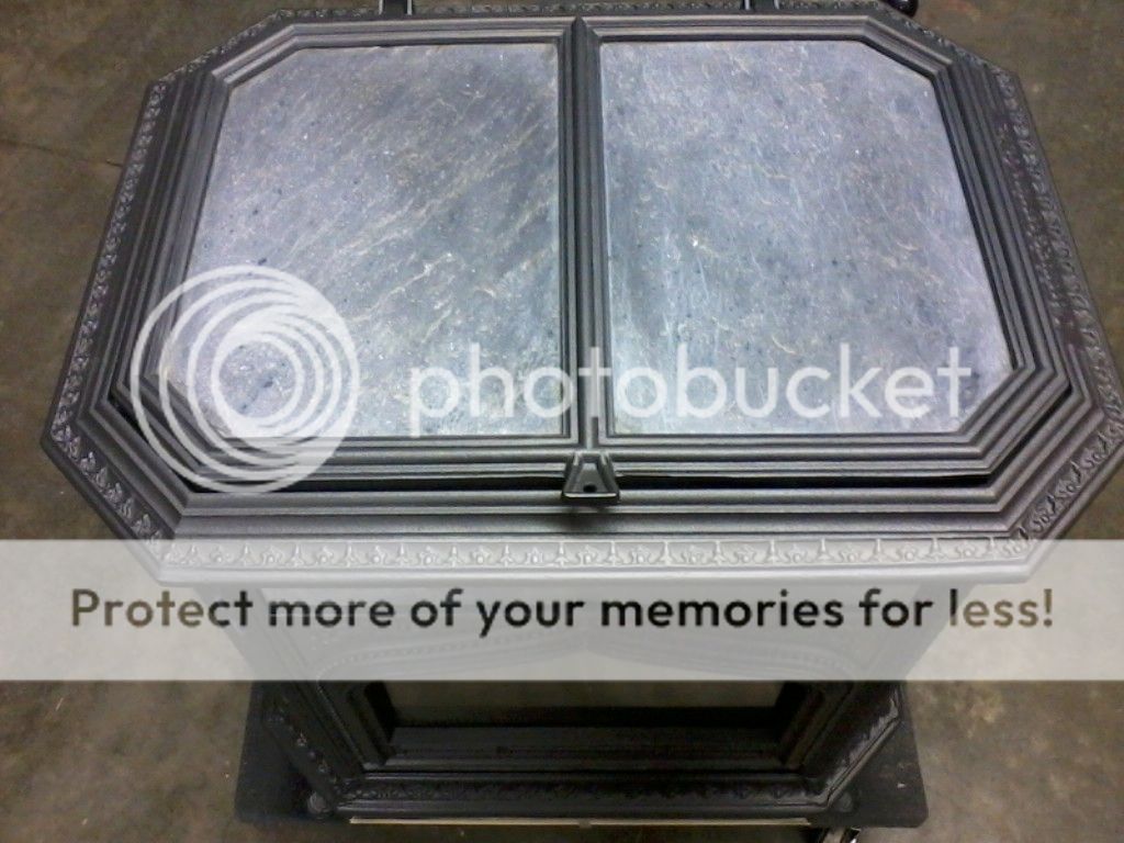

At this point, it was time to start the refurbishing. I disassembled some of the inside to replace the gaskets, catalyst, bypass door, scoop, andirons and one piece of the glass that I couldn't get clean. I also wanted to change the color from metallic blue to charcoal. I buffed out a lot of the scratches in the soapstone, wire brushed the surface rust off the cast iron and then masked it off to paint. I bought a couple of cans of charcoal colored stovepaint from Woodstock and painted the cast iron.
At this point, I have to wait on some parts to come in so I can begin to change the gaskets and put it all back together. This basement remodel project is going to take a few months so it will end up being April or May before I can get the stove moved to the basement and installed. I can see now that I'm going to get impatient. I will have a hard time waiting until next fall for my first fire. ;)

After installing the bypass door and gaskets, I adjusted the fit of the bypass door and the side door. Woodstock has great instructions for the adjustments and it all worked perfectly.
I then installed the new glass, andirons and glass retainer.

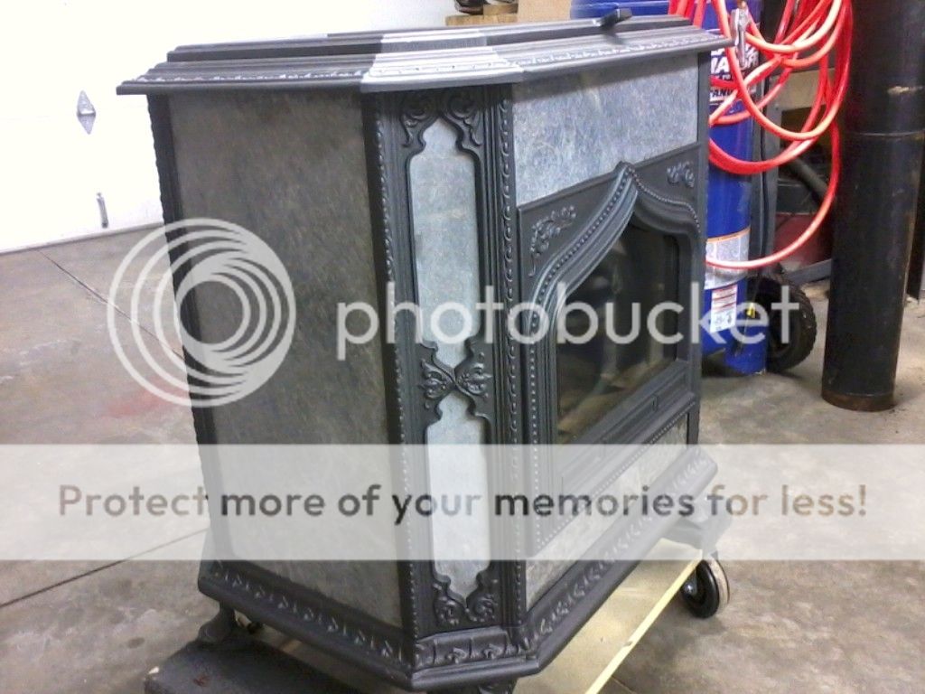

The soapstone cleaned up nicely with some 0000 steel wool and I'm loving the way that it's coming together. I'm still waiting on the new combustor and combustor scoop. After that, I think it will be ready to go.
Stove is looking like new ! Great job!
+1. Bēēautíííful!
It doesn't get much prettier than a charcoal Fireview. :)
Nice pics showing how easy it is to field strip this stove. :)

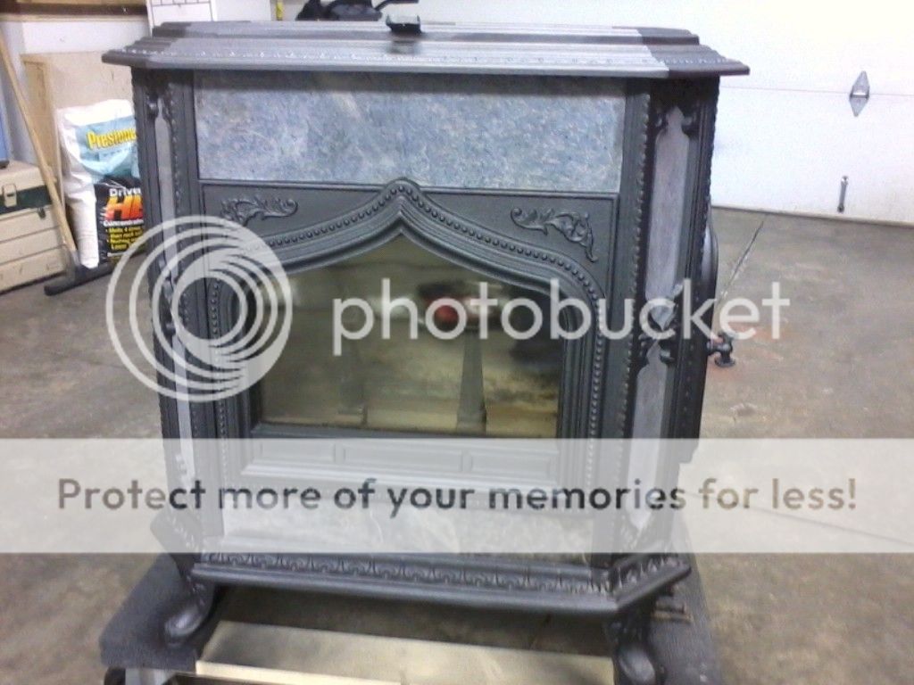

hiites, that is some great work. Looks like a new stove and looks the same color as ours. Feed it good fuel and that thing will throw some serious heat and will last you a long, long time.

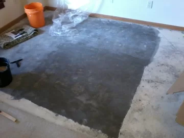

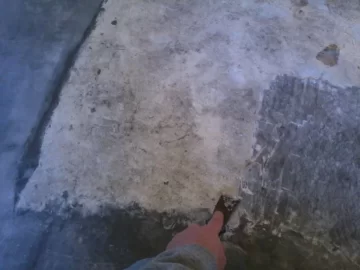

I planned on removing the carpet on one end where the stove would go and staining the concrete. Easy peasy, right? I pulled the carpet back and found that the builder had left the concrete uncovered during the drywall work and painting. So, I had to strip the paint and get down to the concrete.
I used a product called Soy-gel that actually works pretty good. Very low odor.

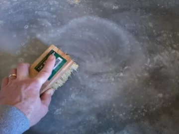

Then I had to scrub the concrete.

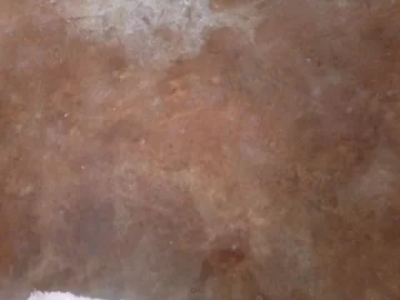

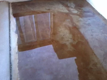

I finally got the paint stripped and applied an acid concrete stain. That was pretty neat stuff. It reacts with the top layer of concrete and doesn't look like much until the top coat is put on. Then, the color ends up having lots of depth. Here's a shot before the entire area was covered with the top coat. I used a Varathane Floor Finish.
Here it is all covered with top coat.

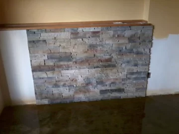

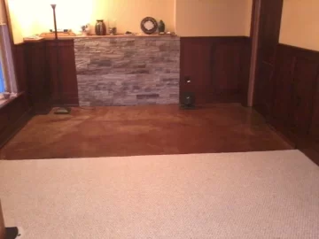

With the concrete done, I wanted to install some "rock" on the wall that would be behind the stove. I went with fake rock product that was installed like tile.

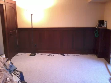

After that, I began to install my wainscot. That took way longer than anticipated. I bought rough cut, quartersawn oak lumber and milled it down into the dimensional lumber needed. It turned out to be more plainsawn and riftsawn that quartersawn but I was still happy with it. Except for the panels, I bought some 1/4" quartersawn oak plywood from Menards for that. The get the color that I wanted, I went on with a water based dye and then put a darker gel stain on top of that.

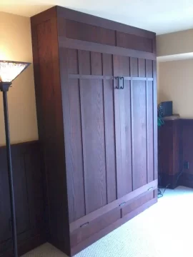

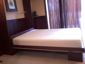

At this point, I still don't have the stove installed and I had some family due for a visit and I wanted to get a Murphy bed built on the end of the room opposite from where the stove will go.

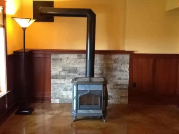

Then, I finally got to install the stove. I went up with the Simpson DVL stove pipe then had to go to the left before I could go out the wall. It's not the most ideal set up but it's what I had to do with the limitations that I had to deal with. I had to miss my sliding glass patio door on the main floor.

Stove looks awesome and the room is great too! Having just installed one in my house with plenty of vertical lift before it was in the house and on the hearth, I totally appreciate your 1 man effort getting it off a pick-up! !!!

It looks great up until the murphy bed. Check with your local authorities but usually a woodstove is not allowed to be put in a bedroom.
