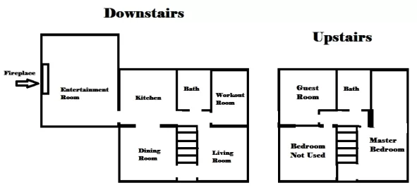

I purchased my first home in New York just over a year ago. We are out in the middle of some corn fields and wind can cause some serious use of our oil in the winter months. Last year, I spent just under $3300 for oil in the cold months of the year (End of Oct. - Mid April, set at 68 degrees, house is decently insulated with new dual pane windows). Our house is just under 2,000 sq. ft. and I would like to lower the cost I spend on oil by purchasing a wood stove insert for where my fireplace is now. I have access to wood for free, so the cost of wood would be at my own expense of cutting and splitting it. I know that the cost of an insert and installation is going to be high, but it should pay for itself within a few years.
I have attached a drawing (excuse my paint skills :p) of the layout of my house. The problem is that my fireplace is on the left most part of the house in a room that has no second level over it. All bedrooms in the upstairs are over the kitchen, dining room, workout room and living room. The bedroom I sleep in is the furthest room from the fireplace which isn't that bad because I like a cooler room to sleep in. Most of our time is spent in the entertainment room so that is a plus.
I still am in the beginning stages of looking for a stove and will be going out to a couple hearth showrooms soon to check out the inserts, but I would just like to see who else out there has a similar home setup and what they might do to make the stove most efficient to save money on heating oil. I know that I could set up some doorway fans to move hot air to other rooms, but are their certain stoves that are made for houses built like this? Should I get a stove that has a higher heating capacity than 2,000 sq. ft. because of the way my house is set up?
Any information would be extremely helpful! Thank you all in advance and I look forward to reading what you all have to say.
Thanks!
[Hearth.com] My first wood stove insert
Welcome. The stove is an area heater. I would size it for the entertainment room and perhaps consider a second stove in the dining or living room? Otherwise this is more wood furnace territory if the goal is to heat the whole house with wood and there is a basement.
Wood stove is a space heater so you have to rember it will take a while for the hot air to move around your house. You will have a better chance of moving it by pushing cold air towards the stove not the hot air away from it. Looks like it's going to be challenging to move that hot air around your house. You would have a better chance if you put a stove in a dining or living room by the stair case. If I was you I would go with a blaze king stove. That's because they are very efficient and they allow a long burn times so you would be able to run it 24/7. They are a bit pricey but I would imagine that at the cost of oil heat it would pay for itself in two years. That's if you get free wood. Also rember that modern stove needs a well seasoned wood that means stacked and split for at least 2 years for hard wood. Moisture content should be 20% or less in the middle of a split. This is the best website for wood burners. There is a lot of very knowledgable people here. They will walk you through every step of wood burning adventure you will learn a lot. One thing I have to warn you. Wood burning and this site are very addicting. All that said ask as many questions as you can come up with don't be shy. People here are ver helpfull.
If you want to attempt to heat more of the house, go up a size from the area heater and do as prezes13 mentioned. Blow air from the hallway, down low, toward the stove room. Us a table fan or small floor fan and set it in the hallway pointed toward the entertainment room. Run it on low speed. The cooler air the fan pushes toward the stove room will be replaced with warm air from that room.

Weatherguy, I would love to have the insert because its just nice and cozy to have in the entertainment room. Yes, I do use that room and the kitchen most, but I'm starting to think that I would rather have my whole house warmer. I need to get to a store and keep researching online to see the cost difference as well. Looks like an insert and furnace could be around the same price (depending on installation fee). I'm a pretty handy guy (woodworker/mechanic/all around) but when it comes to fire in the house, I feel like it would be best to have a professional install.

Is it a full wall between the entertainment room and the kitchen or a half wall? Is it a prefab fireplace or is it a "real" one. If you can fit a nice-sized insert in there and have a half wall between the insert and the kitchen I'll bet you can make a big dent in the oil bill with an insert and the floor fan on low blowing into the entertainment room as mentioned above.
It is a "real" fireplace. Just has a clay flu all the way down and a damper that you open and close. We burn just for visual in the winter but doesn't really heat anything unless you sit right in front of it. The wall is a full wall. The doorway is the only way into the kitchen. I'm sure if I set up a fan and get an insert it will help at least a little.
