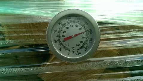

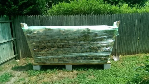

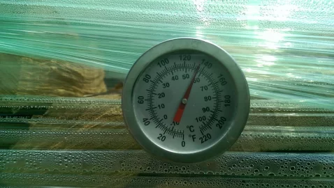

I've got an 8 foot by 4 foot single stacked bunch of black locust that I wrapped in some shrink wrap. Didn't do the bottom. It gets sun most of the day.
It's 86 degrees out right now and my probe thermometer is showing approximately 135 degrees.

Well, at 135 F during day time the moisture needs a way out to evaporate (upwards). Having it not wrapped at the bottom is good so it can drain out when it is cooler at night. So punching some holes in the top might help.
I've got some maple that's in one that I've measured the moisture content. It doesn't get as hot because it's not getting full sun.
You would think you want holes in the top but apparently they aren't needed. Guys on another site have done this and weep holes in the bottom or not covering the bottom gets enough moisture out when it condenses and runs down the side to be effective. I'm sure it could be tweaked to make it better but a simple wrap job like this makes a big difference and doesn't require much time.
Reactions: Jan Pijpelink
Looks like some condensation on the plastic? So that should run down & out the bottom.
Be interesting to see the results.
Yeah, it runs down the sides and out the bottom.
If you tack some scrap wood on the sides so the shrink wrap doesn't touch the fire wood it keeps the condensation off the firewood totally.

Man, you know this thing is going to work. Once that moisture has cooked out of the wood, I'd be hard pressed to imagine a scenario where its going to go back INTO the wood. None of my storage spaces have access to full sun or I'd be all over this.
The bit of data I'd be interested in is how big a split needs to be before this isn't as effective. What if you only had to split the wood half as much as you do now? And the follow-on would be if it works as well on a (say) 3" round as a 3" split.
One thing I did notice is how much the wrap keeps the heat in. At 530 this morning the probe said it was 82 inside the wrap. It was only 64 outside. The sun hasn't been on it for about 8 to 9 hours at that point.

You have failed to understand the process the wood is not wrapped tight there must be a standoff of the wrap from the wood to allow condensation to collect at the top and drain down the sides ( like a triangle or Cone). It does work, additionally the heated wood loses heat quite slowly in comparison to the rather rapid rise and fall of the external conditions. At the moment I have apx 2/3 of cord of marginal wood in my small garage - it is in the high 60's out right now but still close to 80 Inside. This with a 30 inch screen door. I use a fan just to move the air around and get some exchange through the screen door. Days that are at least mid 70's with Sun will have the interior of the garage at 100+::F or more. I can feel the difference of humidity in and out the first few days of a new stack being placed in there. Of course days that the external humidity is way high slows the process, but no more than a conventional stack sitting outside in the elements.
