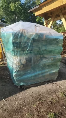

I have put together some mini kilns to season some of my wood faster. I have a friend that is in need of wood so Im helping him out. I put this together on October 2nd, obviously the sun angle is getting low so high heat temperature are not expected. It was a high of 70 degrees and the inside kiln temperature was 114... Not bad. Today november 24 it is 43 degrees the sun angle is alot lower and the inside wood temperature by my IR gun says the wood was 86 degrees. I believe that you can season wood fairly quickly with smaller kilns over the course of the fall, winter and spring. I dont think that the larger ones I have done in the past would be this warm.
The mini kiln is just a pallet with wood stacked on it. This kiln is exactly half a cord, 4x4x4. It is up off the ground higher then the other kilns. This is on 6x6 RR ties. The sides are wrapped with contractors stretch wrap, plastic put over top. The plastic was put on with the center being 14 inches high in the center and 2 small u shaped vents cut open. More wrap was put around the plastic to hold it in place. Im going to do a test split tomorrow to see how its going. I did test the wood prior to stack and the wood was in the low to mid 30s.. hers some pics

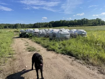

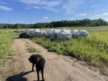

Along with 15 unwrapped pallets, here are this years 24 mini kilns, wrapped in May/June. Wood in upper half or so of each one is coming out at 10%, lower portion at 14%-16%. I leave the kilns intact until they are in the woodshed, under cover. I can put six in at a time which gets me through about 8 weeks.
View attachment 286280 View attachment 286281
that looks good, Im trying to see what kind of results I can get in cooler weather. I haven't really tried to speed up the seasoning process in late fall early winter
Last year I had 8 pallets that I didn't get wrapped until early September. When I brought them in in late February they had gone from mid-twenties to mid teens but we had had relatively warm weather through until mid Oct. This year I tried leaving some splits a bit bigger and the larger (8" and up) weren't as consistently dry as the more uniform 5"-7" that I usually shoot for. Here is a closeup of aa pallet that I unwrapped tonight.

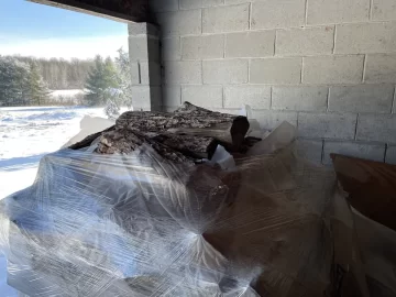

I don't get much moisture change in my kilns when the over night lows start getting below freezing. But I am at 64 degrees north latitiude, so limited sunlight in cold weather also. What I do see (in March) when my daytime highs are hitting the teens and 20s above I have enough sunlight and enough solar gain to get the green wood I stacked over the winter thawn out and then start pulling moisture out of it. By the time my snow is melted the fresh green standing timber from January that I stacked/kilned in Feb is below FSP, down to roughly 30%MC around May first when the raspberry canes start budding and most of the snow is gone.
I don't know why in general I see more action in the spring then I do in the autumn, except I generally go into autumn with dry wood and there isn't much more action to do.
Might check the air temp in there first thing in the morning a few times. As the water in the splits gets frozen you will be burning some daylight to get it melted every day before you can work on getting it out of the splits with your remaining daylight each day.

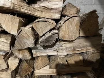

The plastic is recycled from other projects and is on its last leg. I have cut them down to 7x8 size and will use them till they fall apart. I have often thought about the hoop house and just basically baking the wood late spring/summer/fall. I know that this will work. I dont have the space and since I dont ever need that much wood, its not for me. I see the same as you. my greenhouse gets way warmer in spring then fall and early winter. As soon as late February early March rolls around it gets extremely warm in there.

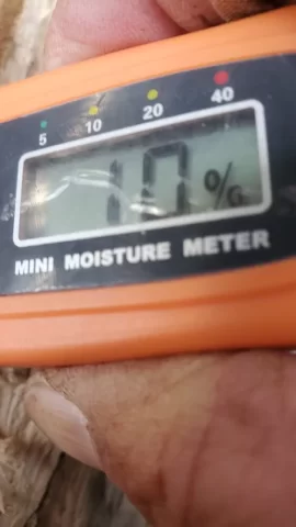

I tested the wood yesterday. The larger splits went from 36/38 to 28/30 and the smaller stuff like 3 inches are down to like 10% from the 30s.. not bad for 60days of drying in fall weather its not very uniform as the pallets need to be turned because the sun angle is low and the back side isn't heating up like in summer time. This is what you learn..
