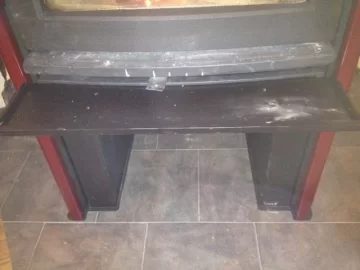

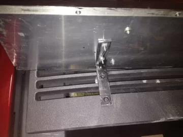

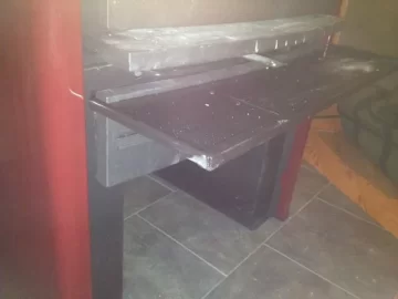

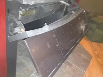

I recently installed a PE Neo 2.5 stove. It works like a champ now that I have learned how to burn with a new stove as opposed to my old Resolute. My only issue was with the very narrow ash lip which wouldn't keep anything from rolling onto the floor if embers or ash should fall out of the fire box. My solution was to fabricate a wider lip and attach it to the movable cast iron ash draw cover. The 3rd photo is of the underside of the unit and the last one is of the shelf tipped down. I made it out of aluminum sheet from a big box tractor supply house and a couple of stout shelf brackets. It bolts right on with no drilling, only a couple of bolts and washers.

Sweet solution!
A stove without an ashlip is like an axe without a handle. Somethings are just meant to be.
