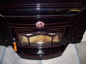

I've been experimenting the last week with temps. I have the rutland on top shelf over the blower vents. Its shelf protrudes out from the door. I think I'll move it back a few inches and see. Anyway with the damper all the way open I hit 275. As Burntime stated this stove should have little problem at 350. I have the fan on auto and it seems to kick on around 150. I have the fan on high. Last night I turned the fan off until it hit 225 and then turned the fan back on. My room where the Hampton is located hit 83 and 71 upstairs around 9:00 pm. When I woke up this morning at 7:00 the room with the Hampton was 73 but the upstairs measured 73 also. Can anyone explain that? Does it take awhile for heat to rise? The fire was going out last night around 9:30.
Takes a while for the natural convection to occur, heat rises. Just enjoy the heat!!!
Here is where I currently have the Rutland.

Move it back to one side and get yourself a half kettle to add moisture, then burn baby burn!!!
