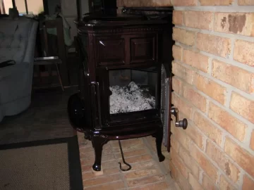

We have a Jotul F600, but only load through the side door. Our install is on a raised hearth and the stove rear legs sit just inside the fireplace opening.
[Hearth.com] My Jotul will have to be front load only...
As you can see, I can open the side door nearly all the way. The F 600 is a rather deep stove measuring 19" from the front glass to the back of the stove. You have a full 16" from behind the doghouse to the rear. If ash spill out was a problem this extra space would let you build your fires further back inside the stove so that less ash would build up against the front door. However, I would recommend you try to manage an installation where you can load through the side as I do since that will solve the ash out the door problem all together.
