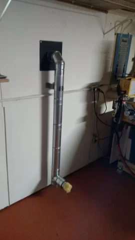

Well the journey has begun. I've been heating my shop, approximately 650 sf, for the last 7 years with electric heat. Made the decision to go with wood pellet heat about a month and a half ago and have been doing some research. Narrowed the search down to 2 possibilities. The Castle Serenity and the PelPro PP60. Went with the Castle Serenity :cool:. I at first tried to acquire one thru Ace Hdwe using their 15% off coupon and they cancelled the order after about a week and a half :confused:. stewed about that for a day and just went ahead ordered it thru Home Depot. Supposed to be delivered to store on 3-16 or 17. Went ahead and installed the exhaust vent using the measurements given in the Serenity pdf manual. Bought the Selkirk vent kit off ebay. Have never used Selkirk before, it seems sufficient, time will tell.

Here's the exhaust vent install:
[Hearth.com] My Journey with a Castle Serenity Pellet Stove.
What kind of shop? Any chance of nasty vapours from fuels and code calls for it being 18" (I think) off the floor. OAK hook-up is mandatory too. May want to check local by-laws if they have more specifics...
Interesting. Do you have any links that would provide more info?
NFPA 211, 2013 edition. Costs to download but you may be able to find it at your local library...

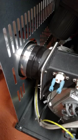

Sunday I decided to seal the exhaust vent to pipe connection. I think it was Lakegirl that suggested this tip in another thread. Anyways, got it at HD and so far so good. Seemed to notice a positive difference right away.
