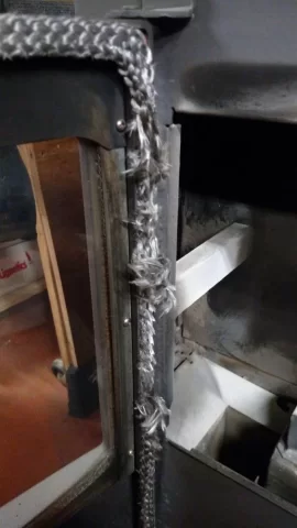

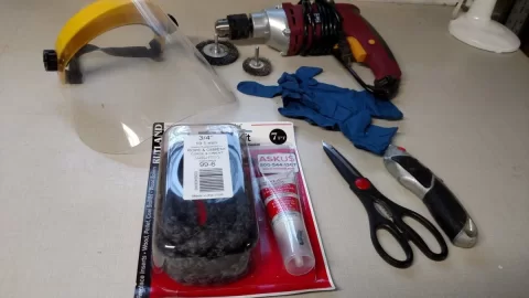

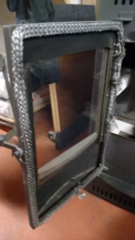

Well, the journey continues. The Serenity has been a true joy, although the door gasket has lived its life. Now midway into it's third season it is apparent it needs replaced. Got this (pic) for a replacement and will do so tomorrow. I'll post more pictures after I'm done, you know, the old failing one, the new one installed, etc., etc..

Pix of the failed door gasket. Don't have a clue what caused this, as it seems a bit premature.

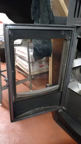

After I scraped out the old gasket with the screw driver.

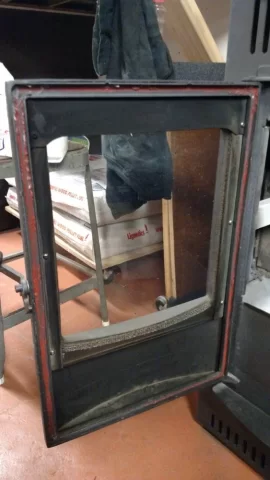

After using the smaller wire wheel and the drill. Vacuumed real good. The reddish coloring on the latch side must be a reflection from the floor (?) as it was down to shiney metal.

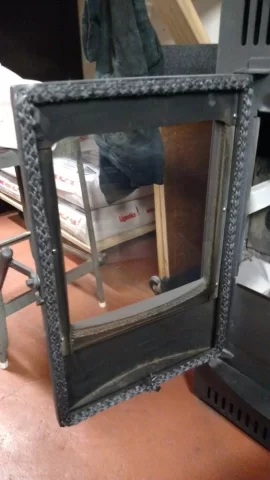

Gasket attached after using the included cement as per instructions. Cut gasket and closed door to set it real good.

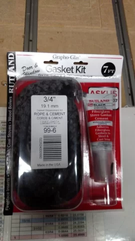

I got mine thru Home Depot. They did not stock it in store so I had it shipped to the store and picked up when it came in. They were accurate on their shipping time. Here's the link (broken link removed)Thanks for the mini write-up on the seal replacement. I need to do this with mine as well. I have one season on it and it's frayed at the corner and there is a gap at the bottom-middle.
Where did you get your new seal kit? I think Home Depot/Lowes has kits but I am not sure if they will work with the Serenity.
The Serenity pellet stove door requires 3/4" rope........ just the diameter or the rope needed is stove door specific Most are 3/8 and 1/2 inch to 5/8 ths on most wood and pellet burners......
