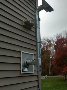

I used a duravent kit but put an extra hole in it for the intake. My vertical rise is on the exterior so it works. It's alot cleaner looking.
