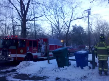

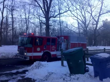

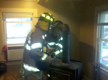

Cleaned out the ashes and restarted the fire. 2 small dry splits, a few small sticks, and a firestarter square. Then the house filled with smoke. The pipe going outside was pouring smoke out of it.

The stove took off like mad. Stove top temp 800+. Outside chimney was extremely hot to the touch. The firemen took it all apart and it was all perfectly clean. I have no idea what happened. Maybe it was that one piece of pine i put in last week... ;)

The smoke was coming from the stove pipe that goes from the stove to the outdoor chimney. all from between the joints. When the FD took it apart it was perfectly clean in there.

Seems to be clean. I didn't climb up there but it looks fine. The firemen looked up the chimney and were impressed by how clean it was. Many of the guys are wood burners too, so they know.

Good to hear that you didn't hesitate to call for help. I'm glad that it turned out ok. It does sound like there was a fire in the connector pipe that may have been cleaned out by the fire. One thing to check is the pitch of the horiz. run. Is it level or does it run slightly uphill towards the exterior chimney? It should have a pitch of at least 1/4" per foot.
How much wood has been burned since the stove pipe was last cleaned?

It looks like it's level, but nothing in this house is actually level, I'll have to check it. This was installed by a guy that has all kinds of certifications, so I trust his install. I'm just passed my first cord since it was cleaned.
Glad it turned out okay.
A level pipe can cause nasty things to happen and the smoke is one. As BeGreen stated, a 1/4" rise per foot of horizontal is required. We went 1/2" per foot and it works great.
The runaway stove concerns me...do a gasket test with a dollar bill to check for leaks.
