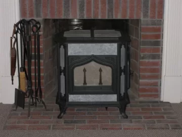

I installed my stove this weekend. Turns out I had a 12x12 clay lined flue that I lined with a 6 in FlexPro liner. I'll fire it up later this week, but looking forward to it! These stoves are really built well. I hope they burn 1/2 as well as they are built. Anyone use the Outside Air Adapter?
-North

Very nice install North. I think you will be very pleased with the burns.
Do you have an ash dump under that stove? I rigged up an OAK to my Keystone through the exsisting ash dump and it's pretty much hidden and works great.
Nice install.

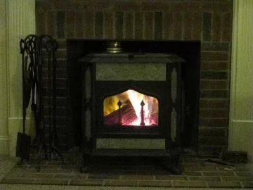

I had the stove inspected yesterday morning. My bride doesn't put her foot down often (like the second time it 22 years), but she heard that our home owners insurance might be void if it something happened and it wasn't inspected, so she wanted it inspected. It passed without any issues and I got two low temp burns in yesterday. I'm on my third as I type this and I'm thrilled with how the stove operates at this point. It's very simple to use. One air lever in the back, one lever for the cat converter, and the door. That's it. The clarity of the fire while it's burning is a delight. My reverence is some of the older VC airtight stoves, and from a viewing standpoint, there is no comparison. So far this has really exceeded my expectations. I concluded through these forums that the Woodstock Fireviews have a sort of cult like following. Now I know why - and I just joined the cult!
It's hard to take pictures of the stove(fire) in operation. Here is an ISO 3200 shot (very grainy), but you get the idea of the beauty of the fire that you can see. This picture is of the stove warming up, but I followed Xraydog's advice and just gave it enough air to see flames (doesn't take much!) and that seems to be perfect.
I'll add some posts as I get more experience under my belt with this stove, but 10 thumbs up to the crew in West Lebanon, NH that are members of the Woodstock Soapstone Company for making a great product. They are a delight to work with and were very helpful throughout my installation process.

Beautiful!
Beauty, and congratulations!
That stove looks great! and is really starting to grow on me.

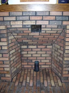

Todd, did you fabricate an adapter for the 4in round pipe to the ash dump or buy one? I think I'm going to work on installing an OAK over the Christmas break when I have some extra time.
-North

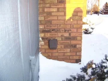

I took out the ash dump plate and the hole was just about 4" square so the pipe fit down with a little persuasion then filled the gaps with mortar. Also rented a masonry hole saw and drilled through from the outside chimney into the ash dump cavity and installed a vent for the fresh air.
