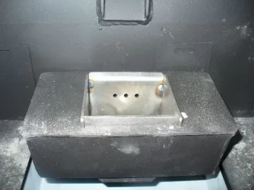

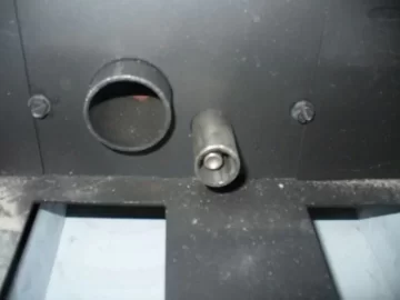

On the left you have the combustion blower "pipe" and on the right you have the ignitor. When the fire box slides in it should be ok.
Take a peek at my visual aids. This is not a BIG E but will show what I mean. Please note I was not in the AV Club.
Eric

Thanks for the picts!
The picts seem to look similar in that the stainless cup/grate where the pellets drop in to isn't totally aquare with the pellet drop slot/hole.
The burn pot seems to be slightly slanted to the right like mine looks. Look closely at them and tell me if you agree.
Like mine but maybe these picts are to a lesser degree.
I would think it's OK since the box still fits over those two pipes with no problems which tells me there's probably nothing bent.

I do not think you will have a problem with your burn pot.

since both of those holes are round it might tilt a little to the left or to the right, this isnt going to be a huge issue, your stove will run fine. there is a little screw on the bottom of the burnpot itself that you can screw in and out to adjust it, that might help but the tilting is nothing to worry about.
Thanks alot for your input Jake.
FG.
