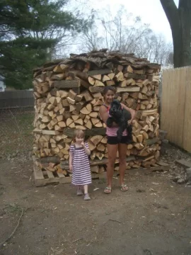

I split up about 2 cords of wood over the last few days and decided to make a holz haus. It's sitting on 4 pallets and is about 6 1/2 feet tall (8 feet diameter). What a pain in the butt to build correctly (I'm still not completely satisfied with how it turned out). If you don't keep the sides straight up and down or actually tilted in a little bit, it is really prone to collapsing. I'm very concerned about the kids next door, (the little one in the photo), so wanted to make sure this was pretty sturdy. This one will be 2/3 of my winter's wood for 2010-2011. Mostly maple in there, but some oak and some ash.
Has anyone built one taller than this? I'd be a little worried about it falling over.

Very cool! How do you stack them like that? Do they get enough airflow to dry?
It's like spokes on a wheel with a spacer every once in a while. I think it will dry pretty good. The entire center is full of loose stacked wood. I've partially covered the top with bark to act like a roof. I think I need to make it a little steeper, both for water shedding and for a better look. I was in a hurry to finish up today and ran out of wood to make the middle stick up. I'll split more in the next week or so and make the roof a little steeper.
As someone who struggles with his wood piles that is very impressive. Nice family too. If that's your daughter, in a blink of your eye she'll be grown up and leaving. Trust me.
Great job. I understand this method of stacking will dry wood faster. I don't think I have the patience for this method. Please let us know how this worked out.
KC
Looks very good for the first attempt. Don't need to add to the top.
Nice job. I know they can be a pita if not built correctly, I had one collapse a few years back. And if you make them too big it's hard to retrieve your wood. But they sure are cool looking.

Nope, it won't dry faster. The main advantages are aesthetics and the ability to store a lot of wood in a small footprint.
Nice stack !
I tried the same thing last week on four pallets. I could not get the wood to stack sturdy enough for my liking so I took it apart and lined up the four pallets and did two rows on the pallets. I split larger splits and any wood that was not perfect did not stack correctly. Since the ring was circular I needed pie shaped pieces which splits do not come as, and my two kids asked me if I could put a door in it.
I would really like to build one of these but could not get it tight. My splits with knots and bulges would destabilize the stacks. I figured I would put all of those on the vertical inside but I did not seem to have enough of the smaller straight splits. I guess this may have something to do with me splitting by hand.

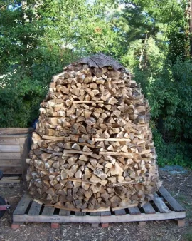

Oh yeah, jdinspector, that's a mighty fine job you did there. I built mine sloped in a little more because I was afraid of it falling apart, but I think I'll try to keep the sides straighter next time. Looks like a giant pinecone....

I really like the looks of the pinecone, honestly.
