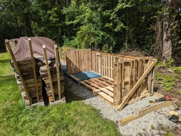

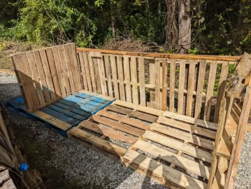

Quick update. I was able to secure my first F150 load of good shape pallets and got the first bay built. A few observations so far:
- I decided to put the back wall on the gravel rather than the pallets. This will allow 3 fulls rows to fit without much overhang, allow easier pallet repairs/replacement down the line, and also spread out the weight of the eventually. This means each bay at its current height will hold just shy of one cord, about 0.95 to be exact.
- Using pallets isn't an exact science as none are exactly the same so there's a lot of "level enough" going on. I screwed a 2x4 along the back to give myself a smooth surface to build up on. I originally planned on another layer of pallets but I think that's pushing it stability wise. I have a lot of scrap PT 2x4s I think I'll just frame a 2' wall and go up that way. There front I'll do 3' for a good roof angle. I'll likely need to add a few more support posts for the front, too.
- The wood itself is going to play a major role in stability. It'll help keep the walls in place and secure. So, I'll likely build wide, add wood, then go up. I don't need to build the entire thing right away. I could but it's not really necessary.
- The gravel and wall are working out nicely. Every pallet I put down is close to level just requires minor raking and tamping. My back is glad it's hard work is paying off.
- So once I get more pallets I'll have 6 bays total holding 1 cord each (we can round up for easy math). Going up another 2ft (plus roof angle is more room) will give me another 4 cords or so giving me 10 in the end of all goes well. It's not quite the 12 I wanted (I use 3-4 cords a year) but it'll be good enough. I still have plenty of other storage I can use.

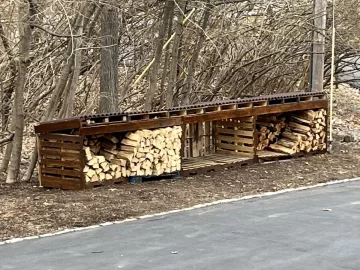

Glad it’s coming together for you. I threw this pallet shed together over the summer. Very similar design (and as some pointed out here, the height will make it a bit prohibitive to get the stacks in the back).
I used pallets as dividers to not only create bays but also help span the gaps. Then used pallets for the roof which then allowed me to put a corrugated asphalt roof right on the pallets.
I may modify mine next summer and go up one level to double my space and make it easier to get to the back row.

Adding the extra pallets on top like the prior poster of the stacks make a big difference on air flow up through the stacks.
I think the biggest problem going up a level is going to be stability. Two pallets high is going to get wobbly. I'm thinking of just framing up another 2 ft with some scrap PT 2x4 I have and fastening that to the pallets.
