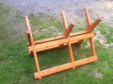

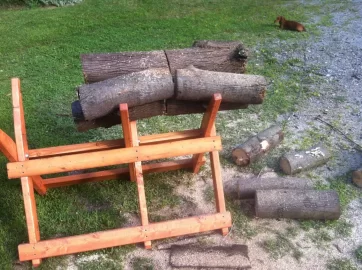

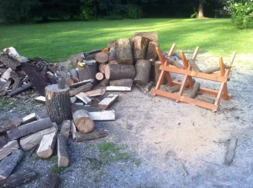

I finished building my new sawbuck over the weekend and its working great. Took a couple ideas I liked, and designed it to suit my needs.
The "crotch" height is 2' from the ground, to match the height of my wood trailer. I offset the center leg, and made the short side 18"OC, my preferred length, which fits N/S in my stove, and 24"OC, which fits E/W. I used half lap joinery for extra strength. [Hearth.com] My new sawbuck

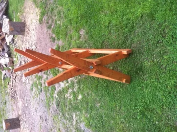

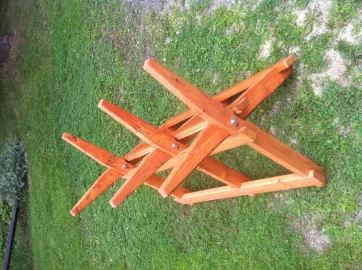

Here is is folded "closed". I had to make a trade off, between folding ability, and the extra strength of the joinery. Takes up about 1/2 the space as it does fully open.

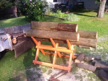

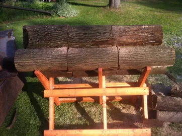

This thing is solid. Here it is loaded up with 2/3 of a smaller Norway maple tree:

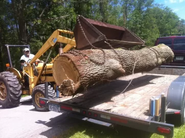

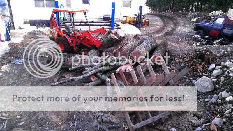

Then my Dad came over with the FEL, so we could really test her out:

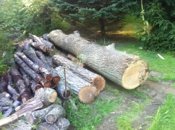

Just kidding. This is the ash log I saved from my 4th of July score. Finally got it home from the neighbors house:

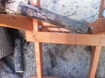

Thanks! I wanted to countersink for the heads of the bolts, but I had to make that relief notch to allow it to fold up, so there was just too much going on right there and I didn't want to compromise the strength.
I already "broke it in" yesterday - started going too fast and nicked it with the chainsaw:

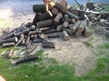

Made quick work of a medium size ash tree, and a trailer load of branch size stuff in the process though:
