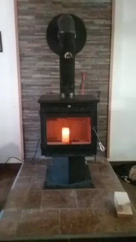

Last winter I was having some issues with our old stove (Magnolia 2015) so we limped it along the rest of the season. After looking at lots of different stoves and probably driving my wife completely insane in the process we both agreed on the Madison, myself on the size and the Englander quality and her on the price. I got a buddy to come help move the old stove out and the new stove in. Was quick and painless. The only major work i have to do is trim my flue pipe down a few inches since its a little taller than the old stove.
The first thing the fam noticed was "wow that glass is huge" and I must agree it has a big glass door that's gonna make for a nice fire view and some sweet radiant heat. I'm also looking forward to the AAS feature on it. If it works like I hope it does that will make loading it a lot easier by taking a lot of babysitting out of it. The ash pan on this is also very large and deep so it looks like it might be worth trying to use at least once. Looking forward to some cooler weather so I can get the break in fires going to "dry out" the bricks and cure the paint.

Looking good. If possible get the break in fires done on days when you can open all the windows and run a fan to exhaust the fumes.

was 85F yesterday, been unseasonably warm here the past few weeks, as soon as the ~50F weather hits i can open the windows and do some break in fires. the candle is battery powered i usually put it in at the end of the season and click it on at night for the light.

I like the candle. Thought I was the only one who put lights in stove. :)
