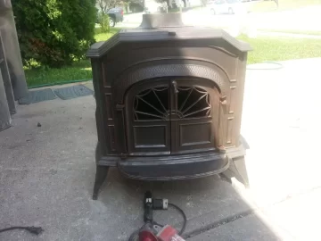

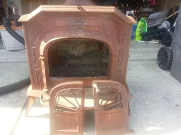

Hello, My next project (see photos) but I am confused, can anyone tell me, was the 1979 VC Resolute made with doors that open? see attached photos. I can't get my hands on the stove for another week or so.

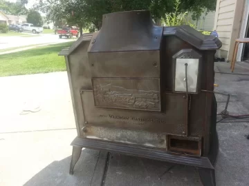

While conducting research I see stoves that look just like the Resolute but the front of the stove opens (one big door see photo- red stove). If that make sense, is that a, Resolute Acclaim?
I want to make sure the VC (rusty) in the pictures is a Resolute.
Thanks in advance for any info.

Rusty one's a Resolute, all right. Resolute 3 in fact, best one they ever made. You may want the 5 gallon bucket of PB Power Blaster to go with it though. Resolute and Resolute Acclaim are commonly mistaken for one another.
This time around for Pete's sake use Rutland brand paint and Furnace Cement. I've never in 25 years heard of that stuff you used on the Vig., and jeepers I hope it holds together and doesn't smell TOO bad when it gets fired up. Rutland stuff is what they used t the factory, and what they send out with repair kits. That or Stove Bright paint. Best of luck!!
Thank you so much. I will post pics when I get it after I finish with it.
I used Rutland Furnace Cement to seal the Vig. I used Rust-Olem high heat on my Intrepid II and cured it outside and it held up well but I will try the paint you suggested.
We had a Resolute 1 stove and loved it. It's sad to see that rusted stove so badly neglected. Looks like it may need sandblasting or many hours with a wire wheel brush on a drill. For painting I second using Stove Bright metallic black paint. That is what is often used on shipping woodstoves. Paint the stove outside or in a very well ventilated area and wear a mask. The fumes from this paint are very strong and can do brain damage. That said it is good paint for stoves and very commonly used.

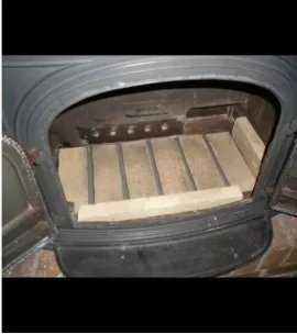

One thing I know is missing is the bottom grate or grates. While I was doing research on these parts. I came across posts where people have ditched the grates, ash pan, and lined the bottom of the stove with fire brick. According to the posts they preferred this configuration better than the factory setup. Comments, feedback?

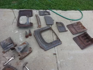

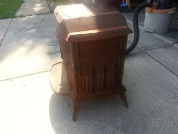

Started working on the Resolute this morning my progress so far and now disassembly begins more pics later as the journey continues.

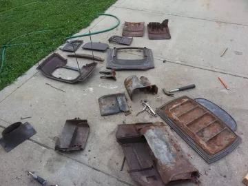

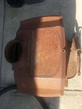

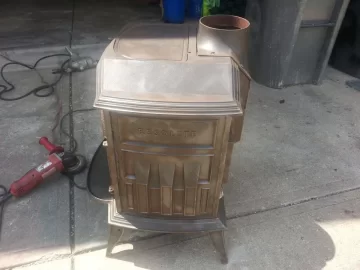

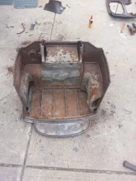

Finally got the stove apart and years of dirt and debris fell out all over the driveway. I really didn't think the stove internally was that bad, aside from having to replace a few parts. It was severely neglected and I think it is a testament of how well these old stoves were built. I would rather rebuild this stove than go out and buy one new. Its something that I will appreciate every time I look at it and I love these old VC stoves.

In good operating condition the Resolute is a pleasure to burn in. Thermostatic regulation keeps it from overheating small areas. Be sure to feed it fully seasoned wood to get the best performance out of it.

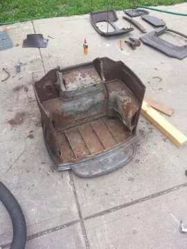

Can anyone tell me where fire brick would go in this stove, referring to picture 1?
