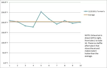

Here's my Turman's results. Generally speaking I liked them a lot but not as much as the Barefoots. They were very dusty and seemed to leave my glass dirtier than the Barefoots. The Turman's measured the hottest so far but my Barefoot results are suspect. It was my first run and I didn't clean the stove before testing them. I suspect that resulted in lower temps and might explain why tubes 1-5 were hotter but tubes 6-10 were cooler than with Okies. I'm going to retest the Barefoots next. Hopefully the more I do this, the more consistent my methods (and results) will be.

Looks like 3 great pellets there. I've burned all 3 and liked them, but you can tell from my signature which one my stove liked best!
