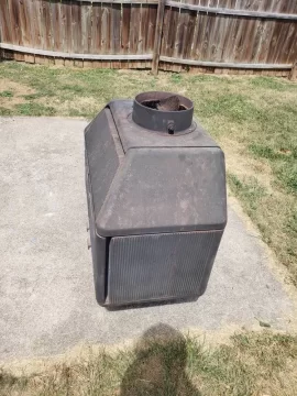

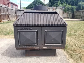

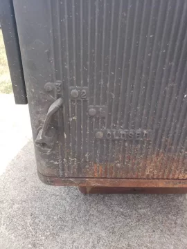

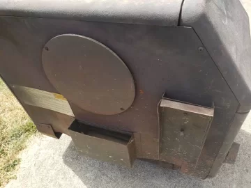

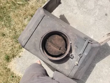

Finally picked up my old woodstove. I'm hoping I can find a way to use it in our new home.

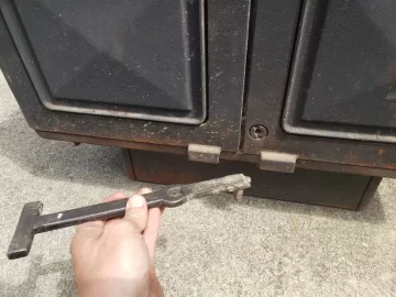

I can use the top or rear flue. It's an early version of secondary combustion and it pits off a lot of heat for as small as it is. It comes with a tool that's sort of a key to open it, and to pull out an optional screen if you burn with it open.

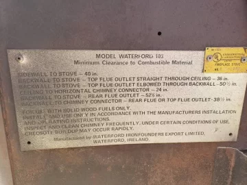

It's a big stove with huge clearance requirements. First, verify it will fit, Second that all clearances to combustible and hearth requirements are honored and third that the fireplace flue can accommodate an insulated 8" liner.

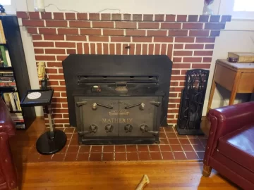

Can you post a picture of the whole fireplace in which it is proposed to be installed?
The waterford is about 30in wide x 30in tall x 18in deep. It's a small stove but puts out a lot of btus.
The fireplace opening is just over 30in high and over 37 in wide.
I could build out a proper size hearth no problem. I'm not sure about the insulated 8 inch liner. The sweep wrote down the dimensions of the flue to be 9x13. They could bust out the flue an extra cost.
So those clearance numbers listed on the plate is for combustible materials right? If so, there would be nothing combustible behind it. Then I should have plenty of clearnce to each side wall.
Sent from my SM-G960U using Tapatalk
30" wide is not small. Nor is the 40" side clearance. Furniture is combustible. I would not go to all this work except for a modern high-efficiency stove. It will heat better with less wood, take a 6" liner, and will provide a nice view of the fire.
We would definitely re arrange the room to get the furniture away. I wouldn't like to spend a bunch of money on a new stove when we have one that we like a lot. It is unique and in good shape. I used it for two years.
