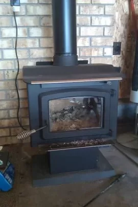

1: I called on this but, me and the guy are playing phone tag, I need help with an ID
I thought It might be an Englander ? Edit : guess not ,doesn't look like them

Looks like a US Stove APS 1100B. If so, it's smaller than the Answer.
edit: you were reading my mind.
;lol Right now a hazy fuzz of cabernet with a background of deer angst.
Reactions: Freeheat and fossil
;lol U must have some signals beaming out of that brain :)
I said to myself ,Hay that might be a US stove and looked it up

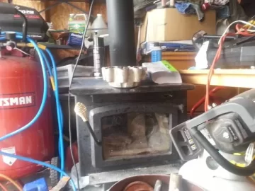

4: Next up, the add says , 55,000 btu wood burning stove ,but this looks like a Vogelzang Performer 2200 sq. ft. Wood-Burning Stove ,which is 119,080 BTU’s per hour
Not sure I want one of these, I would try to buy stove only
Wood Burning Stove

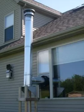

55,000 btu wood burning stove for $750.00. Hearth base, all stainless steel exhaust, extra 3 foot section, power exhaust. Not needed now that I have gas heat.
[Hearth.com] My Stove Hunt, thread ,Need Stove IDs, and Input.[Hearth.com] My Stove Hunt, thread ,Need Stove IDs, and Input.[Hearth.com] My Stove Hunt, thread ,Need Stove IDs, and Input.
4: Next up, the ad
Is the top of the stack 3-2-10?? That stack doesn't look very tall; Is that why the connector has a blower on it?? And through the glass, is that legit?? !!! Maybe his grandpa was Rube Goldberg. ;lol
;lol I thought every one would get a kick outa the setup , that's why I posted those pics also

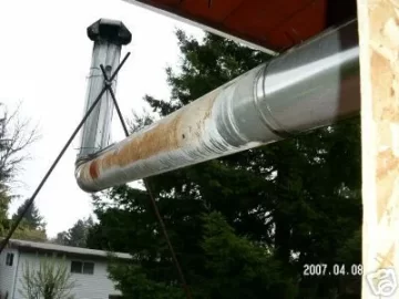

That setup pictured above is so bush league. Nowhere NEAR satisfying 3-10-2 rule. Needing blower for inadequate draft. Off center on hearth pad. Horizontal stove pipe. Thru the glass exit. That is a great example of "Just go straight up". Maybe use 2 x 15* elbows in stove pipe to get CSB closer to the ridgeline. Bet that would have been a great draft AND much less $ in chimney parts. (A SS Tee will set you back). And not look like it belongs on the dirt road where they filmed Deliverance.
Well, with that setup I don't think the stove could possibly have been over-fired.... ;lol

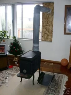

I think these people got the information wrong here , Model ,18-TR 50,, The Englander 1,200 -1,800 sq. ft. Wood-Burning Stove has a 60,000 BTU capacity and a 1.8 cu. ft. firebox
(broken link removed to http://jxn.craigslist.org/for/3992671644.html)
I found it is a 1000 sq. ft. stove that takes a 16" log, AM I RIGHT ;?
The 18-TR ain't no secondary burn stove lately. It was a 35-1 EPA exempt stove. And the fool put a pic of the 13-NC in the ad.;lol
Keep looking.

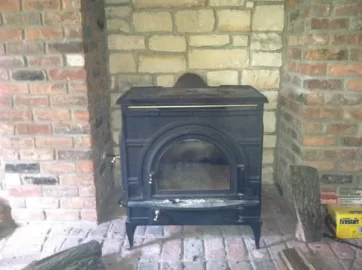

here is a decent deal, just clean her up...(broken link removed to http://porthuron.craigslist.org/hsh/3987194985.html)
These heat up to 2000 sq. ft and have a good rep.
