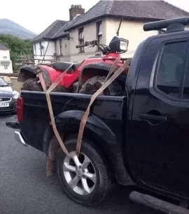

My truck did not like that
Please record yourself telling the motor carrier enforcement officer that after you pull off the portable scales. I would love to see the vid . Overload fines usually start at $1/lb.
You can also get several different fines.
Overload on registered GVW, overload on each individual axle, and overload on each individual tire weight rating.
Overload is also an automatic red tag (impound) until corrected.

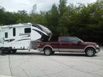

Anybody have a problem with this ????? Towing capacity 10,000 pounds. But, when you put 10-15% on the truck hitch, and add passengers, groceries, your overweight for the truck. Towing is a double edge sword.
I see it near my vacation spot all the time. And I heard they are starting to catch on to this.
