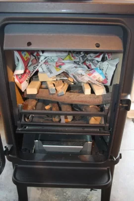

Well, a good thing you can do to relax is to try a very very small fire. I send photos from a top/down ligting in the Morso. Was just to show that Scandinave method for a cleaner lighting and a non smoke back from the lighting. For your first fire, no need to put as much wood as on the photo even if the Morso has a very smaller firebox than your stove. Just put a few (2 or 3) small pieces of dry scrap wood in the stove, add 2 or 3 other small dry branches in the other direction, some crushed newspapers pages on top and fire (light the paper only). Open the air control full ,leave the front door opened one inch and let the fire go a few minutes then close the front door when the wood is burning well.. With a so small load, the risks are near 0. Just forget all the negative parts of the life and enjoy the first fire you did Created. Just an idea if you feel confident with it.

That loading looks full but I realize I will start small--lol That little stove of yours is something and they have such a good reputation as far as In read but mine is nice too and I think maybe in Oct when its gets cooler in climate and then I will see how the air flows and the porch will be painted and sealed at that time as well..More work on the 2nd week of June and in the meanwhile I have the pea rock put on the path to my garage from my basement and i might very well lay some field stone done to make it look pretty and also easier to bring in the pigeon feed.. Work, Work, and more Work and for now that's all we do --some cut ,, others store wood, and others burn wood, Thanks,,clancey
That is a small load of kindling. It is just to start a fire.
Gosh that looks a lot to me for I am talking about maybe five or six pieces of wood and maybe some newspaper to start the fire--lol lol..Maybe when the weather gets cold I might want more wood,,,thanks everybody clancey
It's a tiny firebox and the kindling is small. That amount of wood would barely take the chill out of the porch room on a 40º day. This is a modest load of wood that we would have in our stove on a 40º day.
